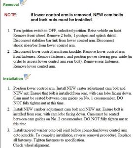

I bought the spindle with ball joints but how do i put them on?
May 14, 2010 at 4:04 PM
BLUELIGHTNIN6
  • 16,542 POSTS
https://images.2carpros.com/forum/automotive_pictures/261618_Noname_2160.jpg
May 14, 2010 at 9:42 PM
