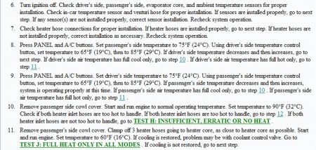

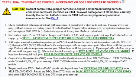

When the A/C is on the drivers side is hot but passenger side is cold, what could be the problem??

Run the self diagnostic test on it by turning the key to on, then press off and floor at the same time, then within 2 secs, press auto, If there is a problem a trouble code will appear on the display...To exit self test, press the BLUE, cooler button this also retains error codes, To erase code and exit, press defrost, choose one of these before you power down the system...post any codes recorded here and I will give you the problem!

I sent a pm to ya.. not sure if these are what we are looking for 88, (small) 8 -188, (small) 8

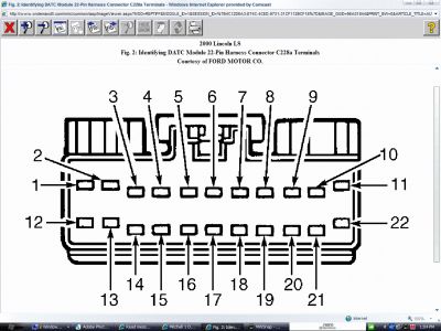

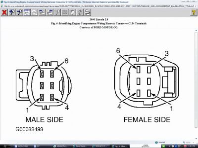

Reply to PM:
