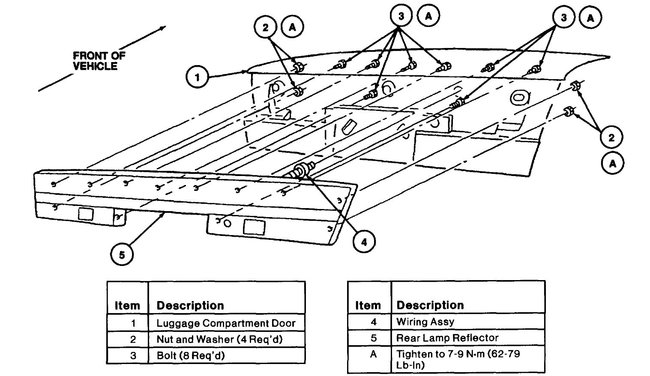

My wife car has over a 100,000 miles. I've replaced calipers & pads, but now I need to replace the left tail light.
It's not intuitively obvious whether the rubber "boot" for the light should pull out of the metal frame it is in.
I've tried rotating and pulling, thinking there might be a key type installation, but to no avail.
Oct 24, 2007 at 1:07 PM
MERLIN2021
  • 17,250 POSTS
REMOVAL
1. Lift luggage compartment door and remove trim panel.
NOTE: The bulbs contained in the rear lamp reflector are non-serviceable. The rear lamp reflector is replaced as an assembly.
2. Disconnect rear lamp reflector wiring from body main wiring.
3. Remove 8 bolts and 4 nuts retaining rear lamp reflector to luggage compartment door.
4. Pull rear lamp reflector away from vehicle.
5. Remove rubber grommet (that contains the wire harness) from the luggage compartment door.
6. Remove rear lamp reflector from vehicle.
INSTALLATION
1. Follow removal procedure in reverse order.
See the diagram below as well

First, you don't have a "V-12" in your car. Lincoln doesn't make these motors. There was only one engine option for you car and that is a "4.6L DOHC V-8".
Here's the procedure for removing your brake lamp. You must remove the entire assembly to remove the bulb.
REMOVAL
From inside luggage compartment, remove lower back panel trim cover.
Remove rear lamp sockets from rear lamp body.
Remove bolts and grommet retaining rear lamp body to lower back panel. Remove rear lamp.
INSTALLATION
Follow removal procedure in reverse order NOTE: Inspect rear lamp lens retainers to make sure seal is intact or a water leak may result.
