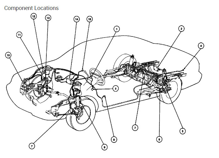

Yes i need to know where i can locate the air pump relay switch for my 95 lincoln cont. because my shocks are in great condition. the mileage on my car is 56,231. v8 engine
Nov 10, 2007 at 8:44 AM
MERLIN2021
  • 17,250 POSTS

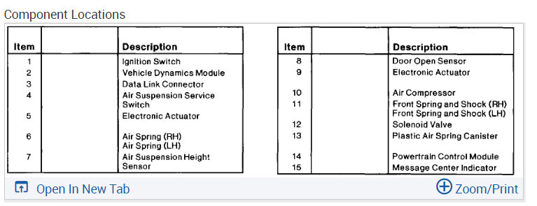

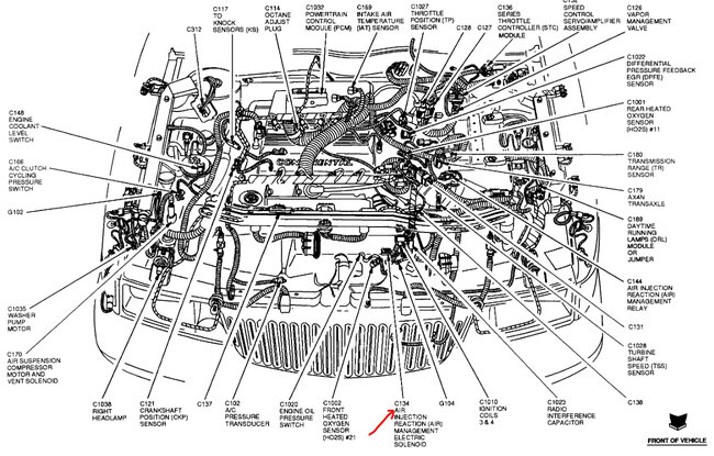

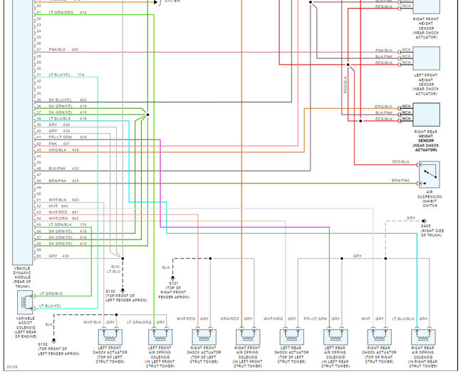

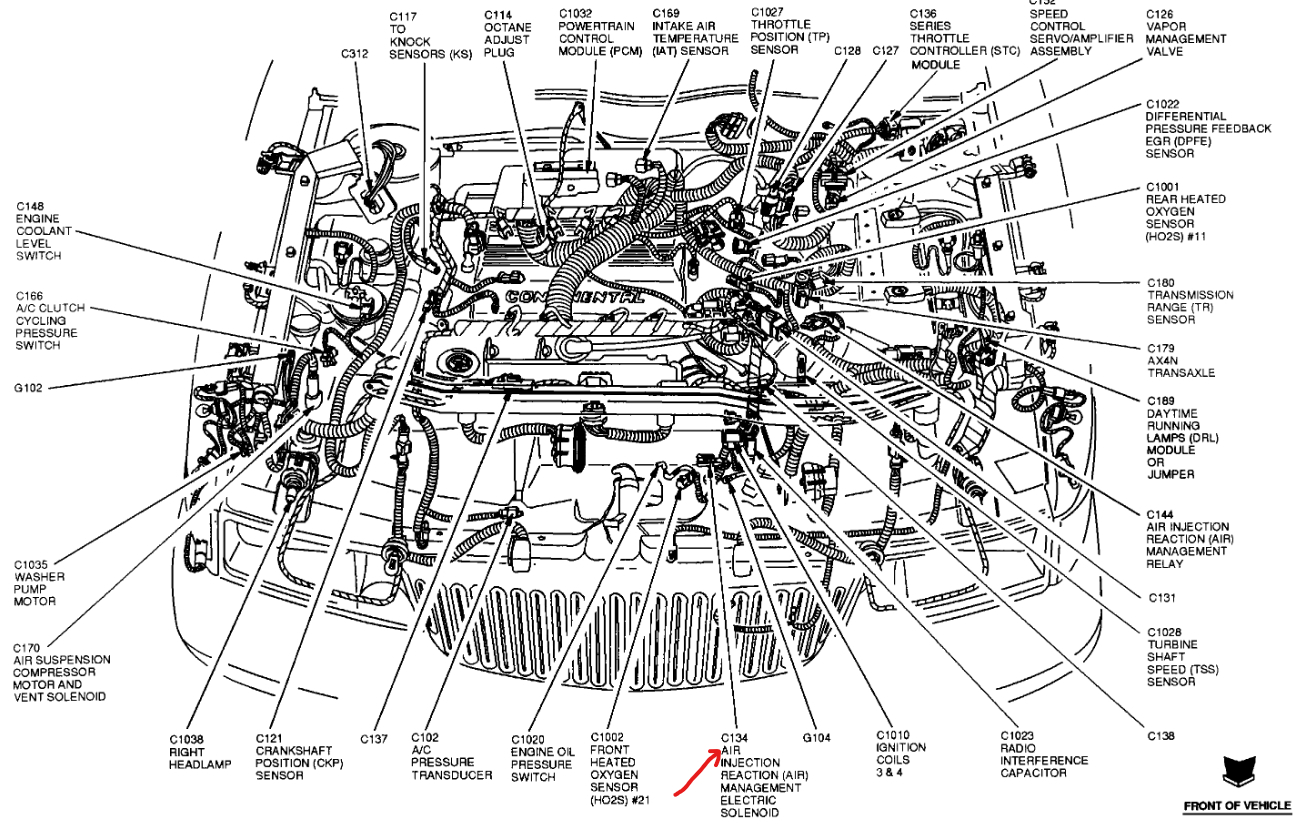

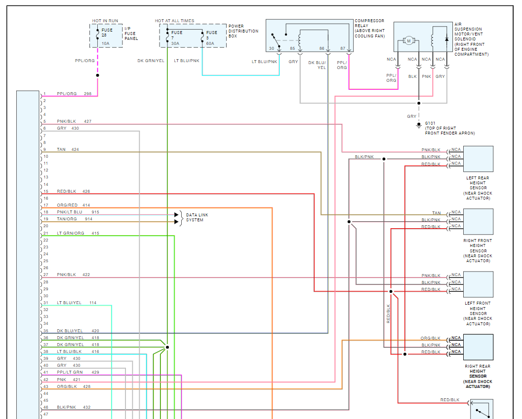

It's in the front and center under the hood above the radiator. Here is the components for the system and I have included the air suspension wiring diagrams so you can see how the system works. Check out the images (below). Let us know if you need anything else.
