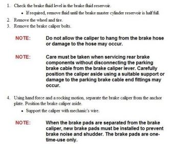

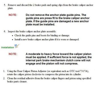

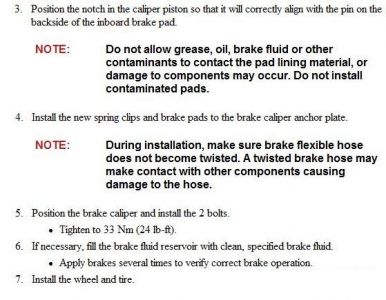

2009 Lincoln Continental 6 cyl Two Wheel Drive Automatic
how to change rear brake pads, how to adjust brake caliper
Wednesday, July 7th, 2010 AT 3:46 PM
BLUELIGHTNIN6
MECHANIC
16,542 POSTS
SPONSORED LINKS
Wednesday, July 7th, 2010 AT 6:18 PM
