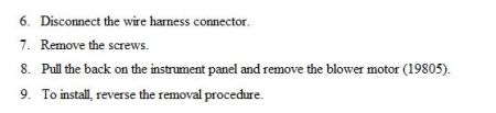

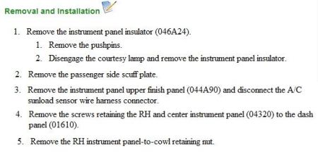

Blower and/or blower motor vibrates and this increased with rpm. Problem is getting worse. Need instructions on how to gain access to the blower and motor, and remove-replace if required.

https://images.2carpros.com/forum/automotive_pictures/261618_Noname_2375.jpg
https://images.2carpros.com/forum/automotive_pictures/261618_Noname2_777.jpg

Your answer may work for a mechanic who does repairs on a frequent basis. For the occasional DIY the answer does not provide diagrams and/or sufficient written descriptions
