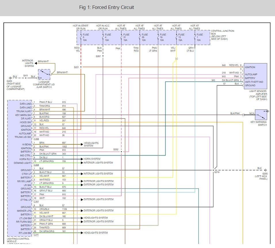

keyless code pad not working
SUZY18US
Electrical problem V8 Front Wheel Drive Automatic 160 miles
when I enter the code on the keypad it doesn't light up when you touch the pad, and the door doesn't unlock. and I have tried making a new code and it doesn't work. How do i go about trying to fix it?????
Aug 21, 2008 at 6:25 AM
  • 55,845 POSTS

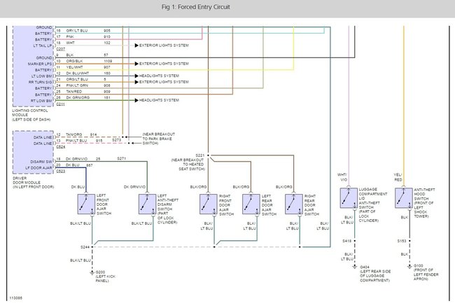

There are several fuses that need to be checked to make sure the system is getting power, here is a wiring diagram and a guide to help you get the problem fixed. If the fuses check out okay I would suspect the drivers door module has gone out.
Please run this test and get back to us so we can continue helping you.
