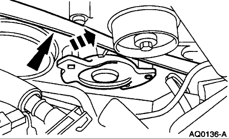

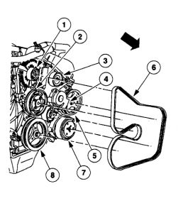

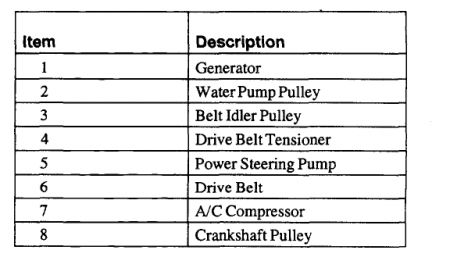

how do you replace the belt
Oct 18, 2010 at 3:41 PM
  • 75,992 POSTS
Service and Repair Removal WARNING: Do not allow drive belt tensioner to snap back, as damage to drive belt tensioner or personal injury could result.
https://images.2carpros.com/forum/automotive_pictures/12900_s1_9.gif
1.Lift or rotate the automatic drive belt tensioner away from the drive belt. 2.Remove the drive belt. Installation
https://images.2carpros.com/forum/automotive_pictures/12900_s2_62.jpg
https://images.2carpros.com/forum/automotive_pictures/12900_s3_13.jpg
1.CAUTION: Incorrect drive belt installation will cause drive belt failure. Note: Make sure drive belt is properly installed on each pulley. Follow the removal procedure in reverse order. https://www.2carpros.com/kpages/auto_repair_manuals_alldata.htm
