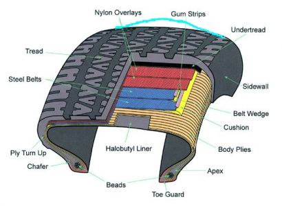

I have a 99 Lincoln Continental, during deceleration (Slowing without applying the break) and braking the steering wheel will start to shake back and forth slightly. Any ideas what might be causing this, or suggestions would be helpful.

Tire with a shifted belt is the first thought.

Certainly, An inside defect can occur that allows the steel belts to be come sepated. The result is a bulge or a lump that causes the tire to no longer be concentric. Stay tuned a minute and I'll see if I can build off that.
Jan 23, 2007 at 10:10 AM
SERVICE WRITER
  • 9,123 POSTS

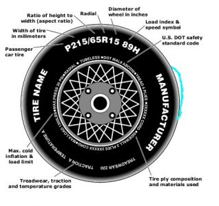

In this picture you can see the steel belts:
https://images.2carpros.com/forum/automotive_pictures/30961_tire_1.jpg
The Blue line represent how the outside will bulge. In this pic:
https://images.2carpros.com/forum/automotive_pictures/30961_tire1_1.jpg
The blue line shows a side view of the defect. As your wheels rotate, it is smotth until the road and this bulge makes contact. Then it is like diving over a bump and the steering wheel reacts. Going faster makes the steering wheel shake. If this is happening, get it taken care of asap as it is unsafe and can cause a loss of control.
Jan 23, 2007 at 10:23 AM
SERVICE WRITER
  • 9,123 POSTS
Is the shaking the same as braking and not braking? IF this is happening when NOT braking, I would expect the above to be true. If the shaking changes when braking, most likley your brake rotors are warped and would need replacement as well.
