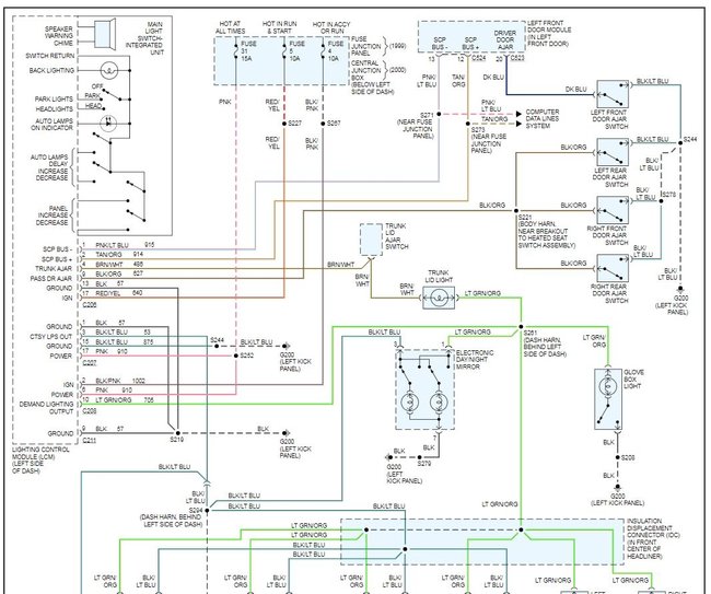

the lights inside my car will not come on , I think it is a fuse but I do not have a book , can u help me . Thank you
Feb 16, 2008 at 9:41 AM
2CARPRO JACK
  • 11,533 POSTS

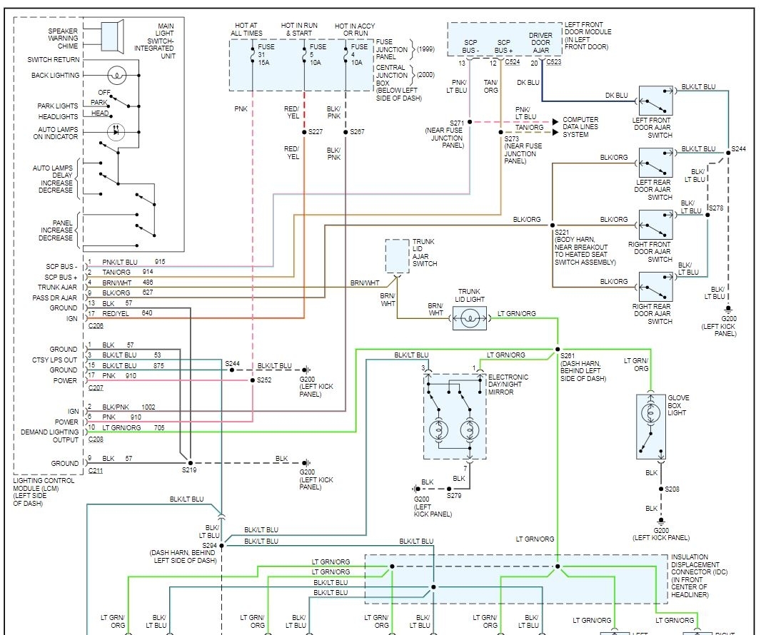

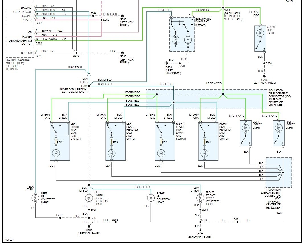

Will they come on if you open a door other than the drivers? check fuses 4,5,31. Everything goes through the LCM (lighting control module). If all door switches test good and fuses, the LCM is most likely the culprit
Read the guide below on testing wiring
The full wiring diagrams for your interior lights are attached below

It sounds like the GEM Module. It is what controls all the lighting and some other stuff.

I would like to know what are the color of the wires going to my door latches that turn off my interior lights. I donated 10 dollars the last time and got an answer about door locks.
Nov 23, 2018 at 1:02 AM (Merged)
DOCFIXIT
  • 18,828 POSTS
Hi
Left front door switch white/light blue is to door moduel illumination module. Black wire ground.
