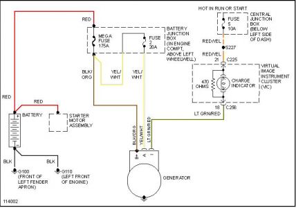

I have replaced the battery and alternator; checked both positive and negative cables; the battery still will not hold a charge. Any ideas?
Sep 11, 2010 at 5:46 AM
  • 75,992 POSTS
Hi aquarius2001,Welcome to 2carpros and TY for the donation. Check all the fuses as you see in the diagram below and make sure the battery and connection are good to include the wiring connector on the back of the alternator-and let me know.
