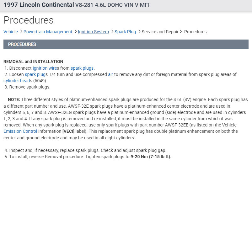

The spark plugs price can vary depending on the material. Platinum tipped plugs will cost more than the copper plugs. Best option would be to follow the guide on the owner's manual as it will recommend the ideal type.
