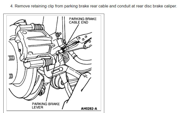

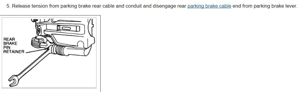

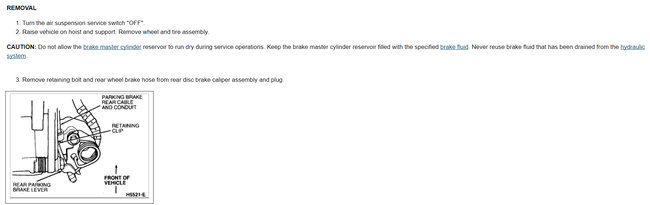

How do you replace rear pads on lincoln continental that has parking brake hose blocking bottom bolt on caliper
Feb 23, 2010 at 2:13 PM
  • 55,423 POSTS
You may need to remove the brake line or gently bend it out of the way. Here is a guide that will help you with the job.
https://www.2carpros.com/articles/how-to-replace-rear-brake-pads-and-rotors
You will need to jack the car up
Here are diagrams that will help you get the job done on your car (below)
