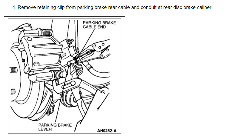

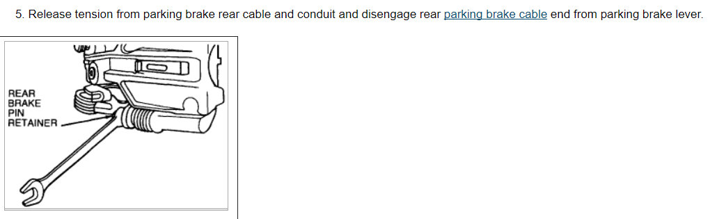

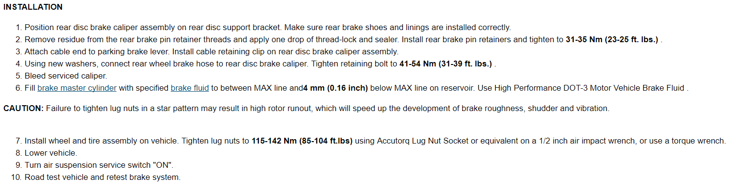

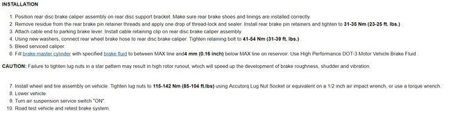

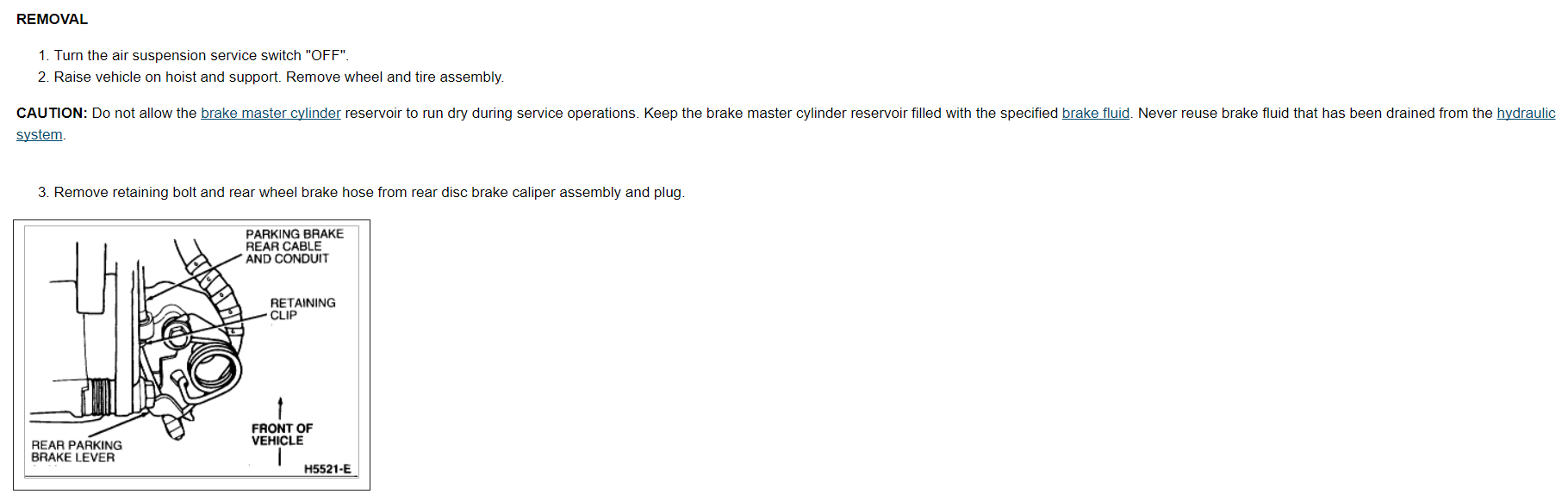

Brakes problem V8 Front Wheel Drive Automatic 112000 miles
How do you replace rear pads on lincoln continental that has parking brake hose blocking bottom bolt on caliper
Feb 23, 2010 at 2:13 PM
  • 55,684 POSTS
You may need to remove the brake line or gently bend it out of the way. Here is a guide that will help you with the job.
https://www.2carpros.com/articles/how-to-replace-rear-brake-pads-and-rotors
You will need to jack the car up
Here are diagrams that will help you get the job done on your car (below)
