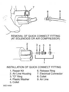

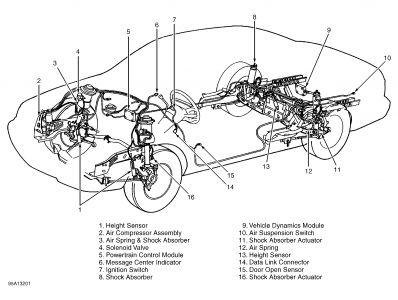

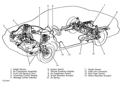

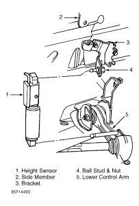

I jacked up the front end of my car with out turning off the air suspension switch. Now the rear off the car is really low and will not raise back up. I can hear the air suspension motor running but the rear will not raise. Is there any way to reset it or what do I do?
Nov 15, 2008 at 2:00 PM
BMRFIXIT
  • 19,053 POSTS
One of two things has happens either you should wait for the system to pump up or one of the air socks has blown out. Try to use soapy water and spray it on the shocks this will create bubbles where the leak is.
