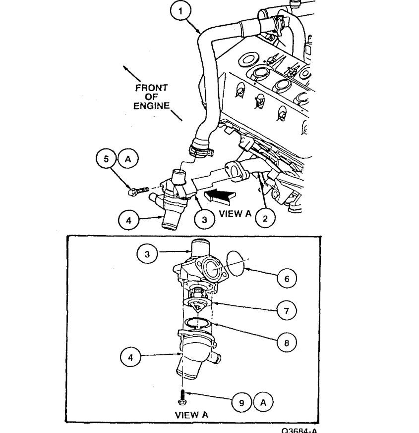

I recently installed a new radiator. However the car is overheating and it seems that the water is not circulating. Maybe the thermostat is sticking, and I need to locate the thermostat. If necessary should I change the thermostat. The car was bought in Canada and may have differences with the US models.
Why else should the car overheat.
I did bleed the system.
Apr 16, 2008 at 9:02 AM
BLACKOP555
  • 10,386 POSTS

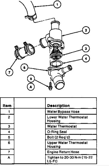

The thermostat on this engine is located at the lower hose, not the upper like some vehicles
replace it, cheap part. after that to check the water pump, wait for the engine to be hot and then hold the upper radiator hose, if pressure builds up and you feel and hear water rush past it it is good.
See the diagrams below for location of the thermostat

Hello, I live in Cd. Juarez, Chih., Mexico, I have a Lincoln 1995 and I want to change the thermostat but I can not find it, could you please let me know where is the thermostat??
The motor is a 4.6 front wheel drive
Nov 5, 2018 at 9:50 AM (Merged)
WRENCHTECH
  • 20,760 POSTS
It's inside the housing shown in the picture.

Thanks a lot for your prompt response, I appreciate it, I have another question, this is for the linconln continental? Because mi car do not have this kind of housing, or the thermostate is below of the motor? Attached is a picture of the lincoln continental motor. Please let me know. Thanks again and apologies for the inconvenience.
WRENCHTECH
  • 20,760 POSTS
That picture was for your exact car and engine. It's in there.
HARDTIME72
It's not in there it's on the front of the engine behind and slightly above the A/C compressor on the front of the engine where the bottom hose goes to the engine
WRENCHTECH
  • 20,760 POSTS
And that's exactly what the original picture is showing.

I found this prior posting from 2carpros master tech rasmataz: "Near the alternator up front of the engine it really always help to look at the new part before you install helps to locate it. From the driver's side at the bottom of the radiator the hose runs across to the passenger side of the car. it turns up into a housing with a secondary smaller hose coming out the side of the housing. If you remove the 2 bolts holding this housing together you will find the thermostat inside with an O ring seal that has to be replaced in the right position when you reinstall the new thermostat." And I am also adding this picture:

near the alternator up front of the engine it really always help to look at the new part before you install helps to locate it.
from the driver's side at the bottom of the radiator the hose runs across to the passenger side of the car. it turns up into a housing with a secondary smaller hose coming out the side of the housing. if you remove the 2 bolts holding this housing together you will find the thermostat inside with an O ring seal that has to be replaced in the right position when you reinstall the new thermostat.

when you stand in front of your car you see the radiator, on the right hand side you see that big black hose that is connected to the radiator and then goes to the engine and the end has that hose clamp, take of the 2 bolts and your thermostat is there, just be sure to drain you antifreeze first and take off the hose clamp.

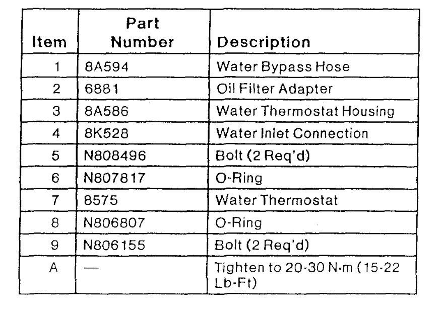

Removal & Installation
1.Raise the vehicle on a hoist.
2.Remove the lower radiator air deflector.
3.Partially drain the engine cooling system.
4.Slide the hose clamp out of the way and disconnect the lower radiator hose from the water inlet connection.
5.Disconnect the hose from the water inlet connection.
6.Remove the two bolts.
7.Remove the inlet connection.
8.Remove the O-ring seal and the water thermostat. Inspect the O-ring seal for damage and install a new O-ring seal if necessary.
9.To install, reverse the removal procedure. Tighten to specification
