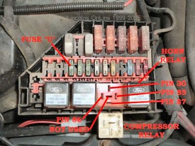

Your "Check Suspension" light has come on, what do you do next? Well the first thing to check is the fuses and that the on/off switch is "on".
Model Year I/P Fuses Under Hood Fuses
90 - 91 1 and 4 A (50amp) and U
92 - 93 1 and 8 A (50amp) and U
1, 4 and 8 A (50amp) and U
95 - 97 7 C (50amp) and U
https://www.2carpros.com/forum/automotive_pictures/52960_00061_1_4.jpg
The picture above shows the power distribution box of a '92 Town Car with the compressor relay removed and placed to one side, fuse "U" and the compressor relay pins labeled.

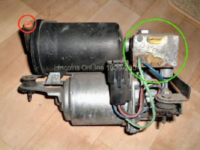

TESTING THE COMPRESSOR AND RELAY
If the compressor appears to not be working, first check the fuses. Then check that the compressor actually works: the simplest way to do this is to remove the compressor relay and with a jumper wire bridge the terminals in the power distribution box for pins 30 & 87. You may get a small spark and the compressor should start.
If the compressor doesn't start, remove the jumper wire and check for battery voltage on pin 30. If you have no battery voltage on pin 30 then there is a fault in the power distribution box or with fuse U. If you have battery voltage on pin 30 then gain access to the compressor and disconnect the compressor harness, reinstall the jumper wire to pins 30 & 87, and check for battery voltage on the Purple/Orange wire ('90 - '95) or Grey/Red wire ('96 - '97). If you have battery voltage then check for continuity to ground through the black wire, if you have continuity to ground and the compressor connector is in good condition then the compressor is bad. NOTE: The wires on the compressor side of the connector are different colors.
If the compressor started when pins 30 & 87 were jumped then the next check is the relay. The easiest way to do this is fit it in the horn relay slot next to the compressor relay slot (first check the horn sounds), and then sound the horn - if the horn doesn't sound the relay is bad. To check the relay is functioning and wiring to the control module, first remove the compressor relay and check for battery voltage on pin 86. If there is no battery voltage then a fault exists in the power distribution box. If you do have voltage refit the relay and gain access to the control module and switch off the air suspension and disconnect the module connector. Now with a jumper wire ground the Dark Blue/Yellow wire (all years) and the compressor should start; if not then there is a fault with the wiring to the module from the power distribution box. If the compressor does start then the module may not be giving the signal to start the compressor, maybe the module, maybe the height sensor.
https://www.2carpros.com/forum/automotive_pictures/52960_00061_2_4.jpg
The picture above shows a Town Car compressor with the airline connection circled in red and the vent solenoid circled in green.

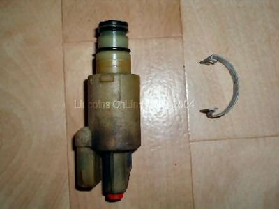

Spring solenoid testing '90 - '94 Town Cars
Switch the air suspension off and disconnect the control module connector. Next, gain access to the spring solenoids and disconnect the solenoid connectors. Now ground the Purple/Light Green and Light Blue/Black wires on the module connector. Next, using a voltmeter or test light bridge the two terminals of each spring solenoid connector and you should have battery voltage (test light lit). If not then connect your voltmeter to the Orange/Red wire of the solenoid connector and to a good chassis ground and you should have battery voltage. If not, check fuse U. If fuse U is okay then you have a wiring fault between the power distribution box and the spring solenoid. If you have battery voltage on the Orange/Red wire and when the two-solenoid connectors were previously bridged you did not get battery voltage then you have a wiring fault on the wire (Purple/Light Green or Light Blue/Black) between the control module and spring solenoid. Finally, remove the jumper wires from the control module connector and with your voltmeter or test light bridge the spring solenoid connectors - if you get battery voltage then the wire (Purple/Light Green or Light Blue/Black) between the control module and spring solenoid is shorted to ground.
From these tests you will know if the wiring is okay. If during the previous venting test one or both air springs didn't vent and the wiring is okay, then it would be safe to assume that you have a bad spring solenoid(s).
https://www.2carpros.com/forum/automotive_pictures/52960_00061_3_5.jpg
The picture above shows a spring solenoid and retaining clip.

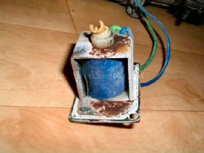

Vent solenoid testing '90 - '95 Town Cars
Switch air suspension off and disconnect the control module connector, next disconnect the compressor connector, then check for battery voltage on the Orange/red wire, if no voltage check fuse U, if fuse U is okay then you have a wiring fault between the power distribution box and compressor connector.
If you had battery voltage, ground the Pink wire on the control module connector and bridge the Orange/Red and Pink wire of the compressor connector with your voltmeter. You should have battery voltage, but if not then there is a fault on the wire between the compressor connector and the control module connector.
Next, with the voltmeter still bridging the compressor connector, remove the ground from the control module connector. If you still have battery voltage indicated then the Pink wire from the compressor connector to the control module is shorted to ground. NOTE: the wires colors are different on the compressor side of the connector.
If the wiring is okay and the previous venting test showed the vent solenoid wasn't venting then you have a bad vent solenoid.
https://www.2carpros.com/forum/automotive_pictures/52960_00061_4_4.jpg
The picture above shows a Town Car vent solenoid removed from the compressor. Notice the corrosion - this is the usual cause of vent solenoid failure. Also notice the broken sealing tip - this occurred when I removed the vent solenoid as it was old and fragile.

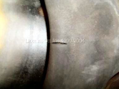

AIR LEAKS
The most common place for an air leak is the air springs, closely followed by the drier/compressor joint and on early 90s Town Cars on the air line just where the frame goes up over the rear axle. Other suspect places are on the spring solenoids and any place there is an air line joint. To test for an air leak, fill a garden sprayer or spray bottle with a strong soap solution and spray the air springs, air line joints, air lines, or anywhere there is a leak suspected or probable and watch for bubbles. To check if an air spring is leaking, allow the compressor to inflate the air springs to trim height, switch off the air suspension and go for a drive or let sit overnight - if the rear of the cars drops significantly then you can be sure there is an air leak.
https://www.2carpros.com/forum/automotive_pictures/52960_00061_5_4.jpg
The picture above shows a Town Car air spring with a crack in it that was almost certainly leaking.

Check Suspension light comes on after driving a while: You have an air leak on an air spring that the compressor cannot keep up with.

Rear of car too high: Vent solenoid seized closed so no venting is possible
Check Suspension light comes on but the rear height looks okay: The vent solenoid is seized closed so no venting is possible.
Moisture is the enemy of the air suspension system and does the most damage to the compressor and vent solenoid usually seizing the vent solenoid closed. The only cure for excess moisture in the system is to replace the compressor/drier assembly, both rear air springs/spring solenoids, and blow through the air lines with compressed air.
