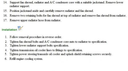

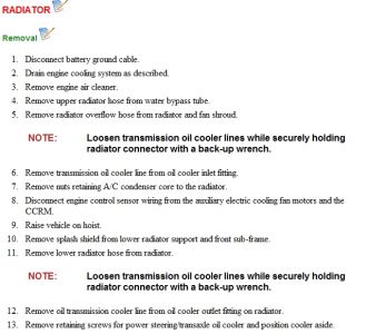

I need to know how to install the cooling fan.
