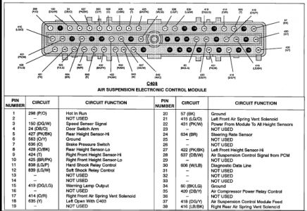

Where is this item and what does this module look like? I have been informed that it is in the trunk on the left quarter panel, I have looked for it there repeatedly. To date I have found nothing that could be a suspension control module. I have only found the radio preamp and amp but nothing other than those items. I know where the on/off suspension switch is but no module there.
I am in hopes that someone is able to aid me in finding this "lost" item. Also please let me know if there is something I need to know about changing it. I am A bit new at this sort of thing. :-[

I can't find a picture of the module itself but I did find a pic of the plug going into it. You should be able to identify it from that. The only info given is that it is located at the LH side of trunk, behind wheel well. There is a diagnostic connector for it near the switch too that should lead to the module. Remember that you have to remove the trim covers to see it.
https://images.2carpros.com/forum/automotive_pictures/561653_Suspension_module_pinout_94_Cont_1.jpg
