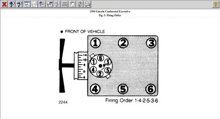

Firing order
1994 LINCOLN CONTINENTAL
PURPLETURTLE036
Six cylinder two wheel drive automatic.
I need the firing order for my sister's car listed above it is a 3.8 fuel Injected automatic sedan.
Please help!
Thank you
May 30, 2009 at 5:44 PM
  • 75,992 POSTS
Hello PURPLETURTLE036, Below is the firing order for your sister's car. Thank you for visiting 2CarPros!
https://images.2carpros.com/forum/automotive_pictures/12900_fo_55.jpg
