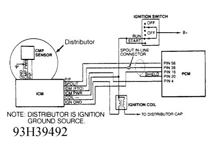

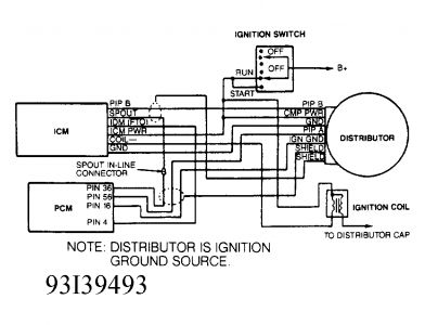

i have just got a 93 lincoln continental. it runs ruff, sometimes it doesn't run at all. computers fine,new coil. it has intermittnt spark. fuel pressuers good. would the ignition pickup have anything to do with the intermittnt spark?...and stalls
