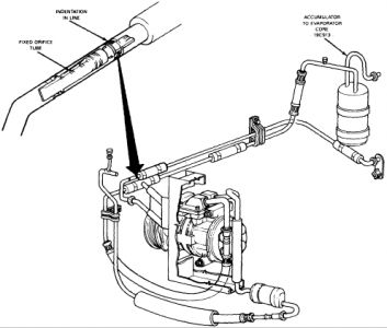

Once upon a time, my car was on a jack. My car slipped off the jack, and jack busted my AC suction line, right near the manifold that attaches to the compressor. Ive tried welding, compression fitting, a hose with crimp fittings, etc to repair this, to no avail-as I can still detect refrigerant leaking.(I am universaly certified). Anyway, I've decide to replace the entire OE assembly, which consists of:
Compressor manifold
suction line
filter/drier
hot gas discharge line (to condenser coil)
--All in one giant assembly with no quick connects between listed components.
The problem is, when I try to find the part online, there is no acurate picture of this factory assembly, or description listing all of the included components, with a factory part number, so I can be 100 percent CERTAIN!! I have what I need. Can someone lucky look up the part on a schematic, so I can have a part number to reference? or better yet-A link to where I can purchase said assembly?

Ready Aire / A/C Hose Assembly
Warranty - 1 YR 35012 $94.99
Note:
Compressor manifold assembly.
Warranty - 1 YR 3431 $71.99
Airsept / A/C Inline Filter Kit
67570 $12.99
Note:
Suction screen
Warranty - 1 YR 3515 $43.99
Note:
Liquid line
I hope this will help

Hello When looking up your vehicle there was a technical service bulleting on this. I have attached it for your review. Since there were problems with this, to me the best course of action is to go to the parts department or call them at the dealer and request the part numbers that way. This way you will ensure you have the correct part numbers based off of this TSB.
https://images.2carpros.com/forum/automotive_pictures/248015_57436866_1.jpg
I see where the receiver dryer is one long assembly. Wow....but again, you want to make sure your numbers are according to the TSB. The only part number I have for a Receive Dryer F3DZ19C836GA. But again, you need to consider that TSB. I do this many times. Get the part number I need from the dealer then go from there. Article No. 93-24-9 11/24/93 AIR CONDITIONING - A/C COMPRESSOR MANIFOLD TUBE FRACTURES - VEHICLES WITH 3.8L ENGINES FORD: 1992-93 TAURUS LINCOLN-MERCURY: 1992-93 CONTINENTAL, SABLE ISSUE: During certain parking conditions the A/C compressor manifold and tube assembly or the accumulator and hose assembly may come in contact with parking blocks and fracture, resulting in loss of A/C refrigerant. ACTION: Install a revised A/C compressor manifold and tube assembly and/or a new accumulator and hose assembly: ^ If the A/C compressor manifold and tube assembly requires replacement, replace the assembly with a new design part (F30Y-19D734-A). The accumulator and hose assembly (F20Y-19C836-A) MUST also be replaced to achieve a correct fit. ^ If only the accumulator and hose assembly (F20Y-19C836-A) requires replacement, it is NOT necessary to replace the manifold and tube assembly to achieve a correct fit. NOTE: SOME KINKING OF THE HOSE MAY OCCUR BUT WILL GO AWAY AFTER RECHARGING THE VEHICLE WITH REFRIGERANT.
https://images.2carpros.com/forum/automotive_pictures/248015_41796046_1.gif
Parts Block OTHER APPLICABLE ARTICLES: NONE WARRANTY STATUS: Eligible Under The Provisions Of The Bumper To Bumper Warranty Coverage OPERATION DESCRIPTION TIME 932409A Replace Manifold and 1.4 Hrs. Accumulator - Includes Drain, Evacuate and Recharge DEALER CODING BASIC PART NO. CONDITION CODE 19D734 01

So it appears that the replacement comes in two pieces, whis is good for ease of installation. Awesome!
This is exactly the level of technical excellence i was seeking.
