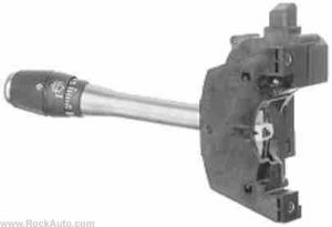

How do I go about changing this. Is it something a back yard man can do?

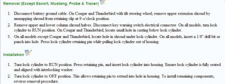

It's called the multifunction switch and heres how...first disconnect the neg(-) battery cable, wait 1 minute, this will dissable the air bag. then proceed as follows:
https://www.2carpros.com/forum/automotive_pictures/62217_IgnSw_1.jpg
https://www.2carpros.com/forum/automotive_pictures/62217_Multi_1.jpg
https://www.2carpros.com/forum/automotive_pictures/62217_Multifunction_2.jpg
