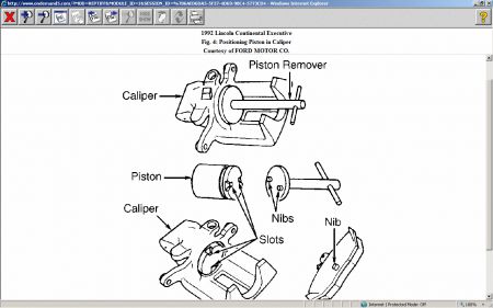

Brakes problem
1992 Lincoln Continental 6 cyl Two Wheel Drive Automatic
I'm PUTTING NEW BRAKE ON THE BACK AND THE PISTON WILL NOT GO IN
HOW DO GET IT TO BACK UP?

When installing new brake pads, caliper piston must be properly retracted. Using Piston Remover (T87P-2588-A), rotate piston clockwise until piston is fully seated. 2.Ensure one of slots in piston face is positioned so it will engage nib on brake pad. See Fig. 4 . Install brake pads, anti-rattle springs and brake caliper. 3.Ensure brake pads are properly positioned.
