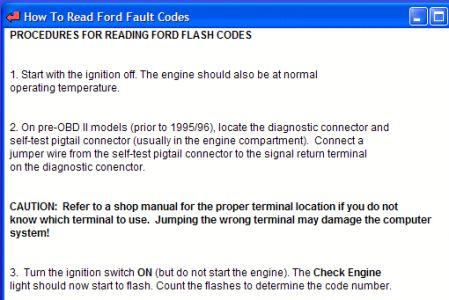

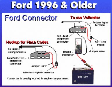

i tried the jumper wire but all it does it flash for probably a minute or two then it says service and the check engine light stays on. I'm i doing it wrong? it continuously just flashes.

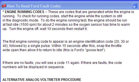

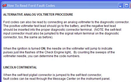

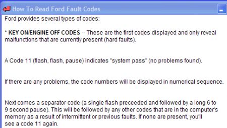

You need to count the flashes! Hook up either a jumper from the single lead to the triangle shaped connector as shown and count the flashes of the MIL, or use an analog voltmeter as shown and count the sweeps of the needle.

i tried the jumper wire and all it does is flash and it never stops. It doesn't flash like its giving codes it just keep flashing for a couple minutes then stops then a service light turns on. i don't get it . is the wire not fully connected? i have a wire with the ends flattened that i stick in the connectors. it seems that its not going in to diagnostic mode. Does the car have to be warmed up?
