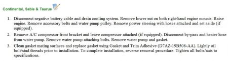

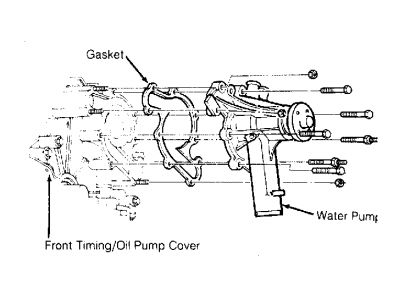

removal&installation of water pump 3.8l v6 motor & what tool needed thanks

https://images.2carpros.com/forum/automotive_pictures/261618_Noname_2895.jpg
https://images.2carpros.com/forum/automotive_pictures/261618_Graphic_764.jpg
