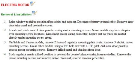

Need detailed instructions to remove and install a new power window motor on the driver side front door

https://images.2carpros.com/forum/automotive_pictures/261618_Noname_1337.jpg
