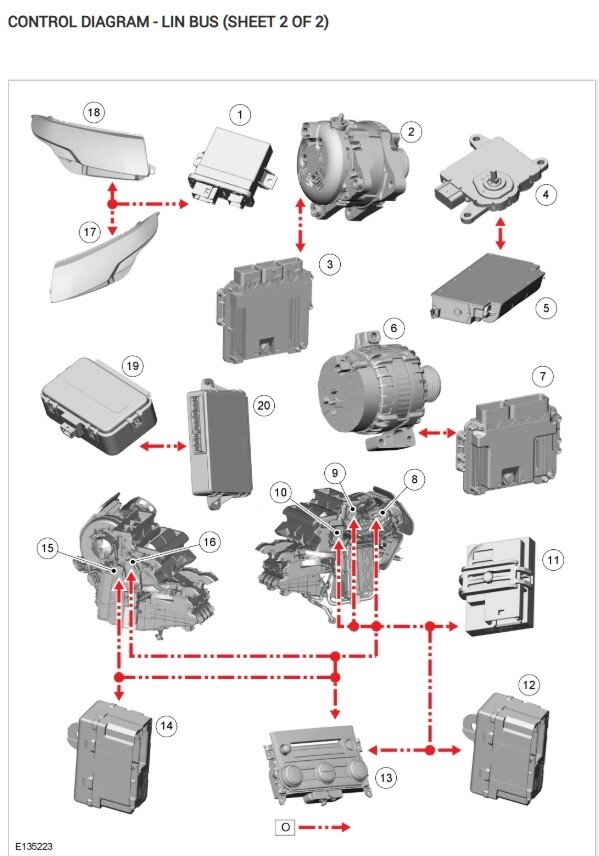

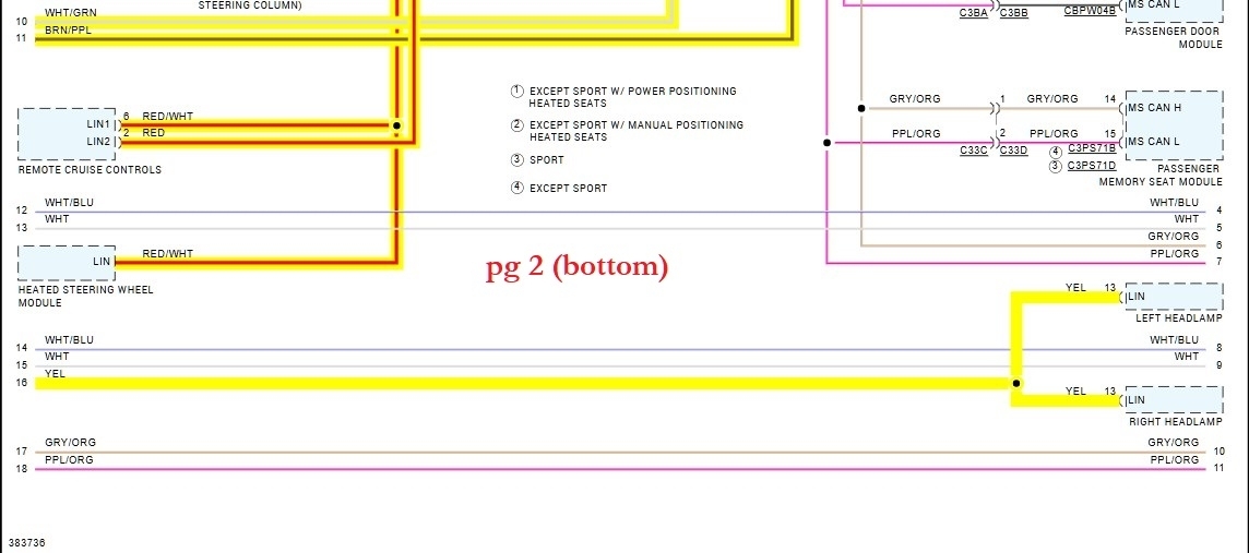

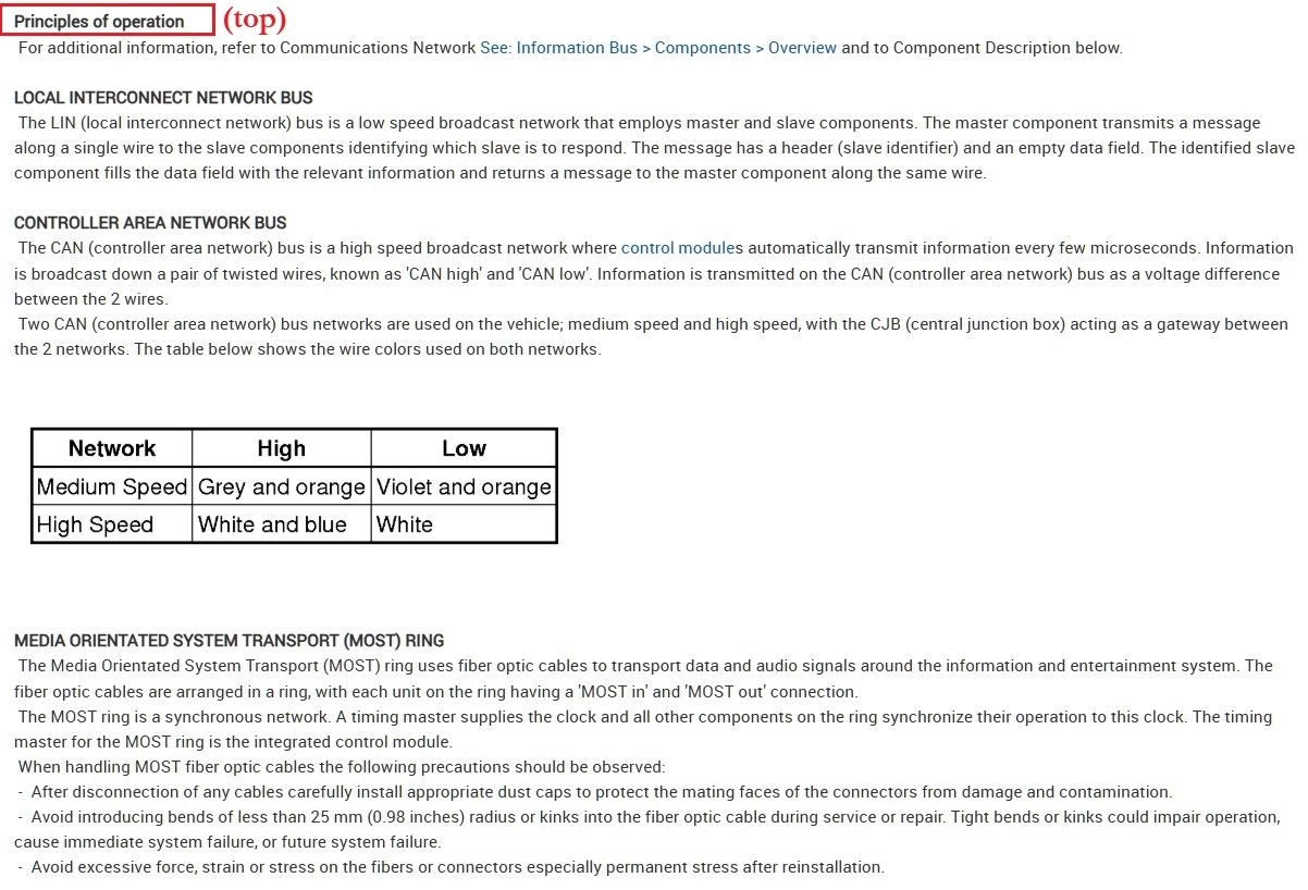

Hi Ken, please may I have the wiring for this engine, power ground and can bus for Lin network system.
Nov 30, 2025 at 10:43 AM
AL514
  • 5,663 POSTS

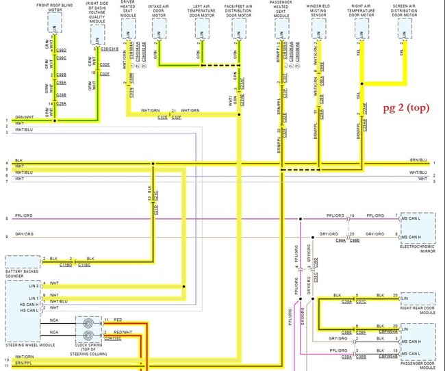

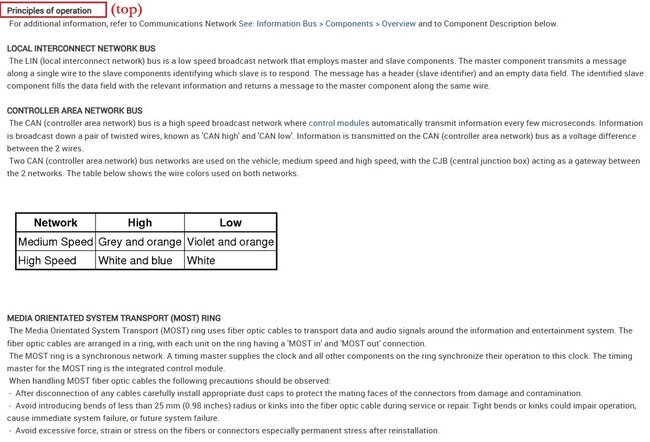

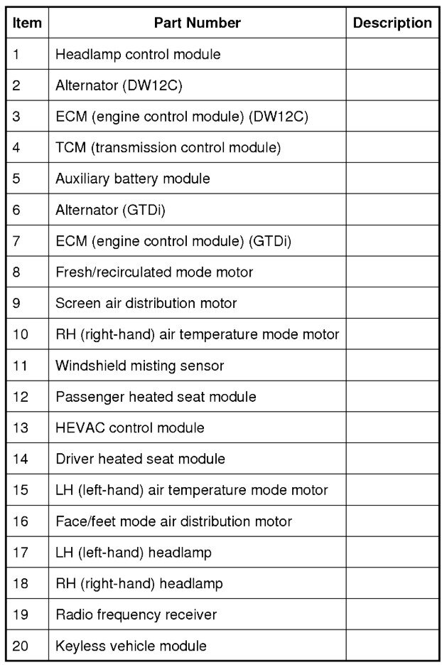

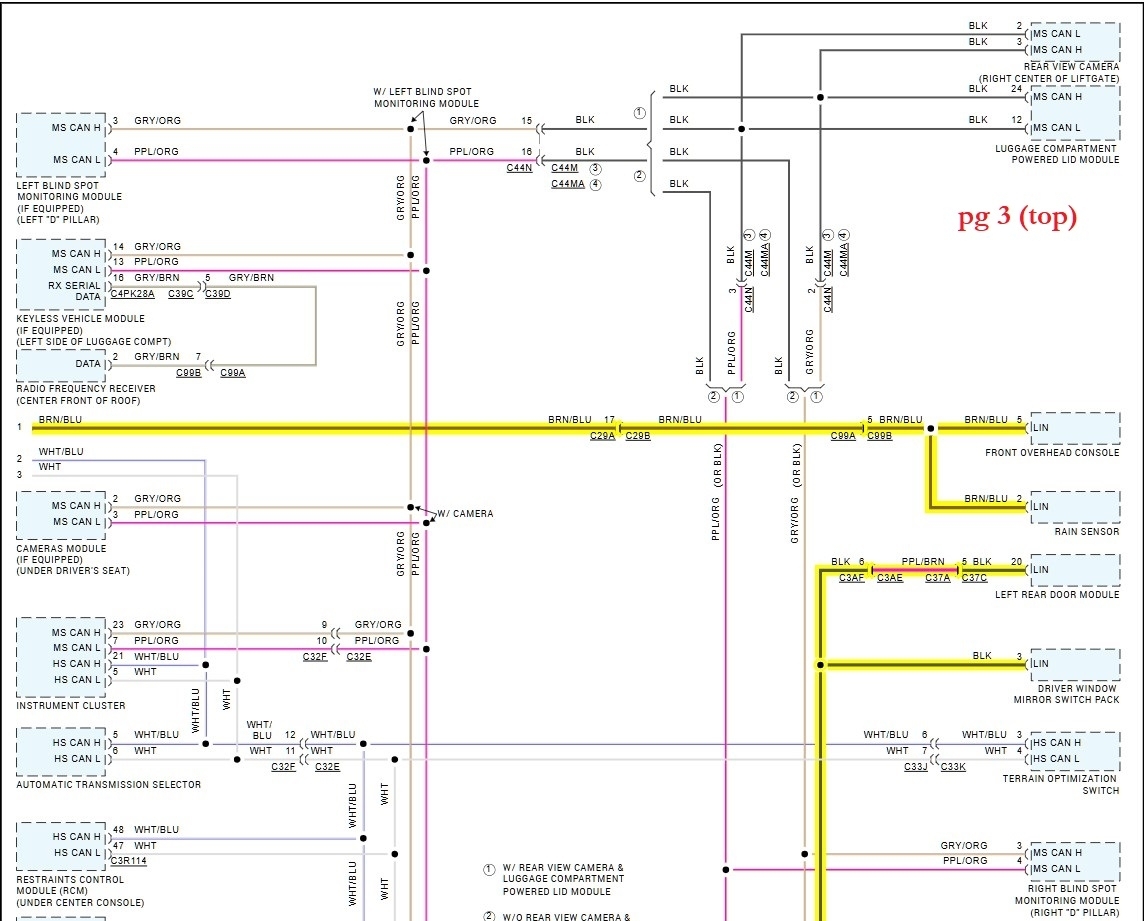

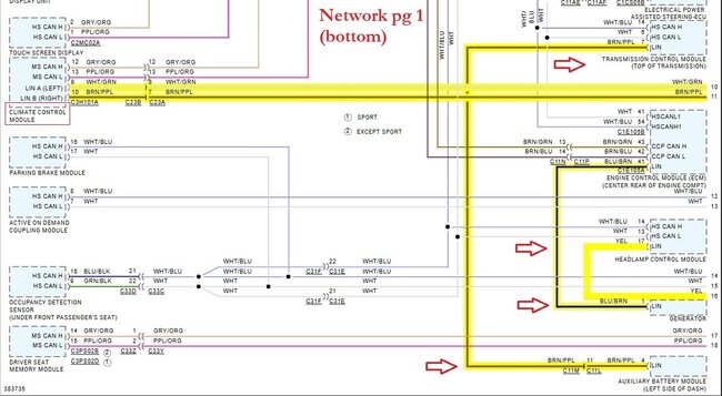

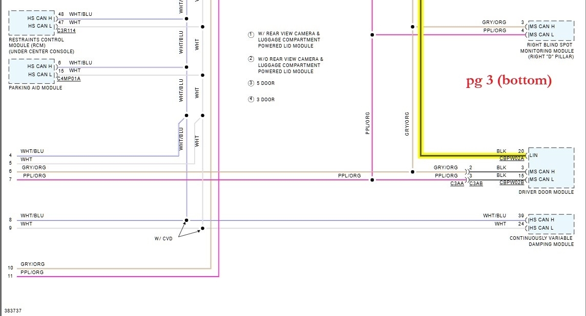

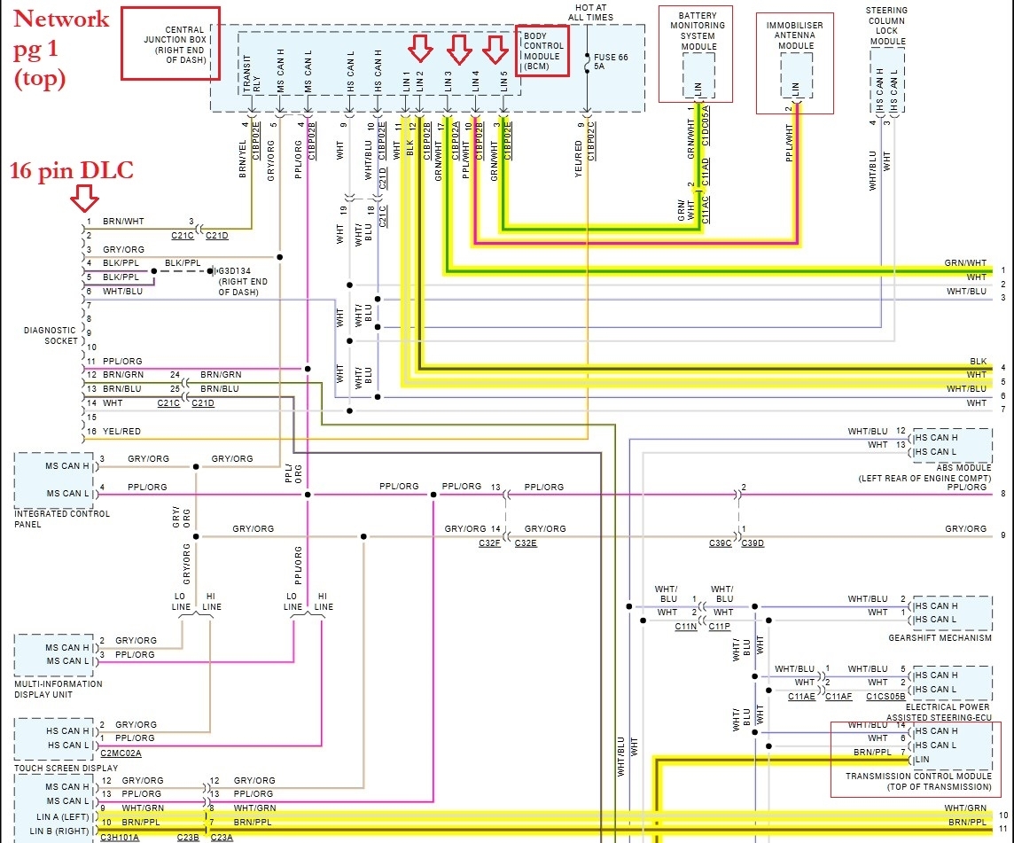

Hello, is there a specific module that is setting the LIN Bus code? A quick look at the network wiring diagrams show there are multiple Lin bus networks for this vehicle. To begin with, Lin Bus is a 1 wire network that is 0-12volt signal, The Body Control Module (BCM) shows 5 Lin Bus networks coming from it. So far I think I count 34 modules on the Lin, but these modules will also talk on other networks as well, depending on how critical they are. Ill get these diagrams ready and highlight all the Lin wires, Theres 3 pages of Network diagrams, so it will take a couple minutes.

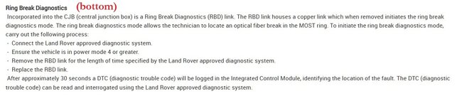

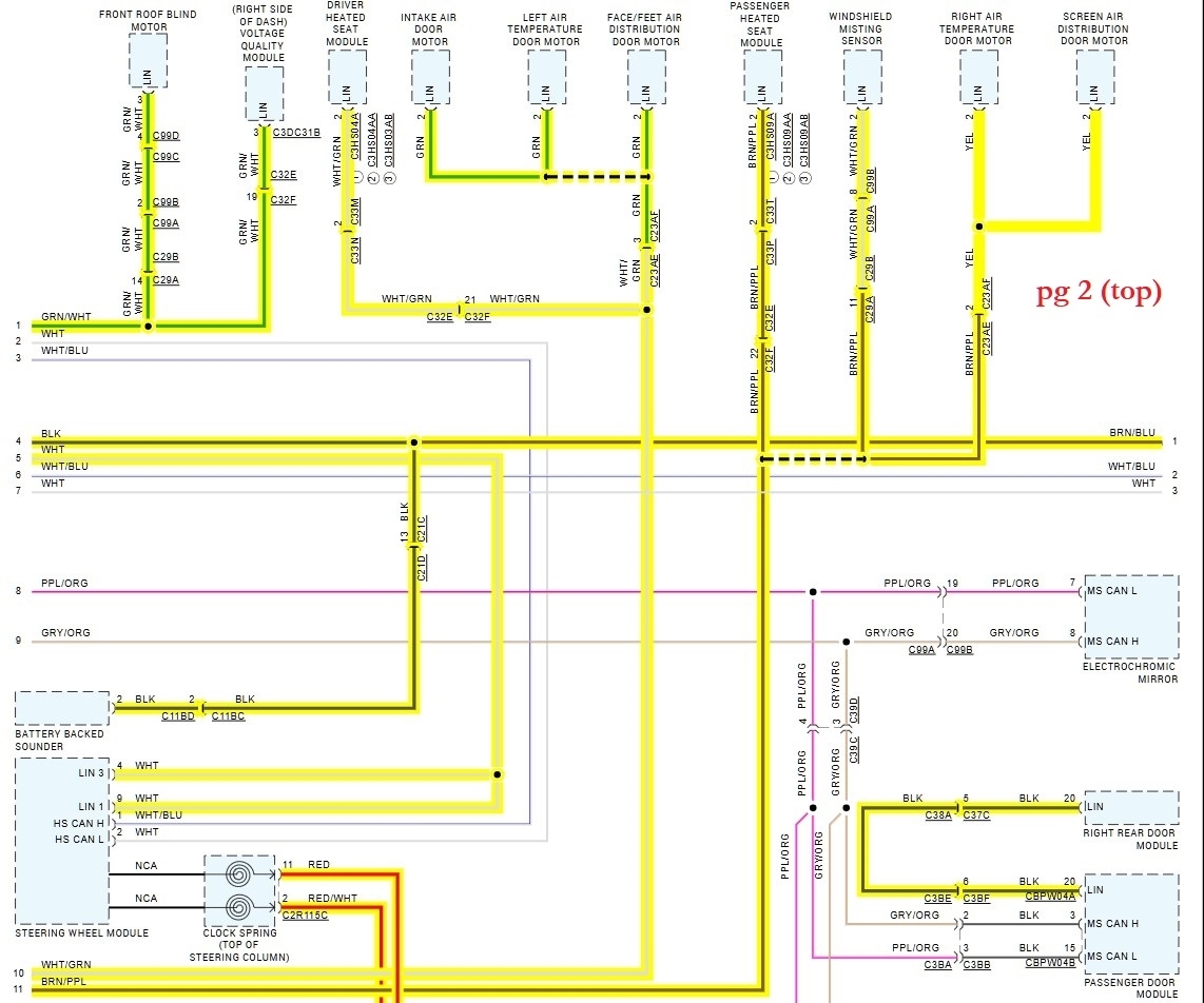

There is a lot of information here, these are for all the networks in the vehicle. Diagrams 1&2 go together (top/bottom) and so on. I have highlighted all the Lin Bus wires and add some network operations info. Let us know what you find,
Dec 2, 2025 at 11:41 AM

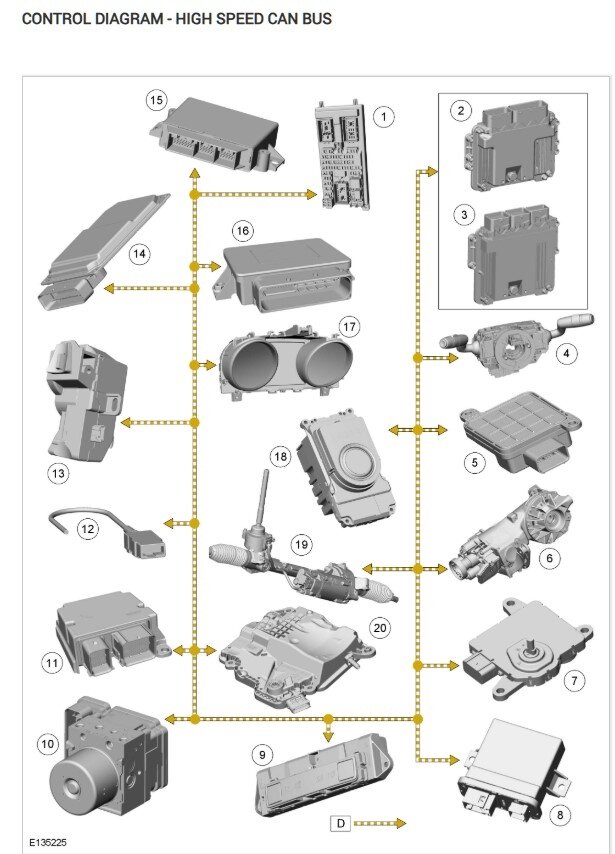

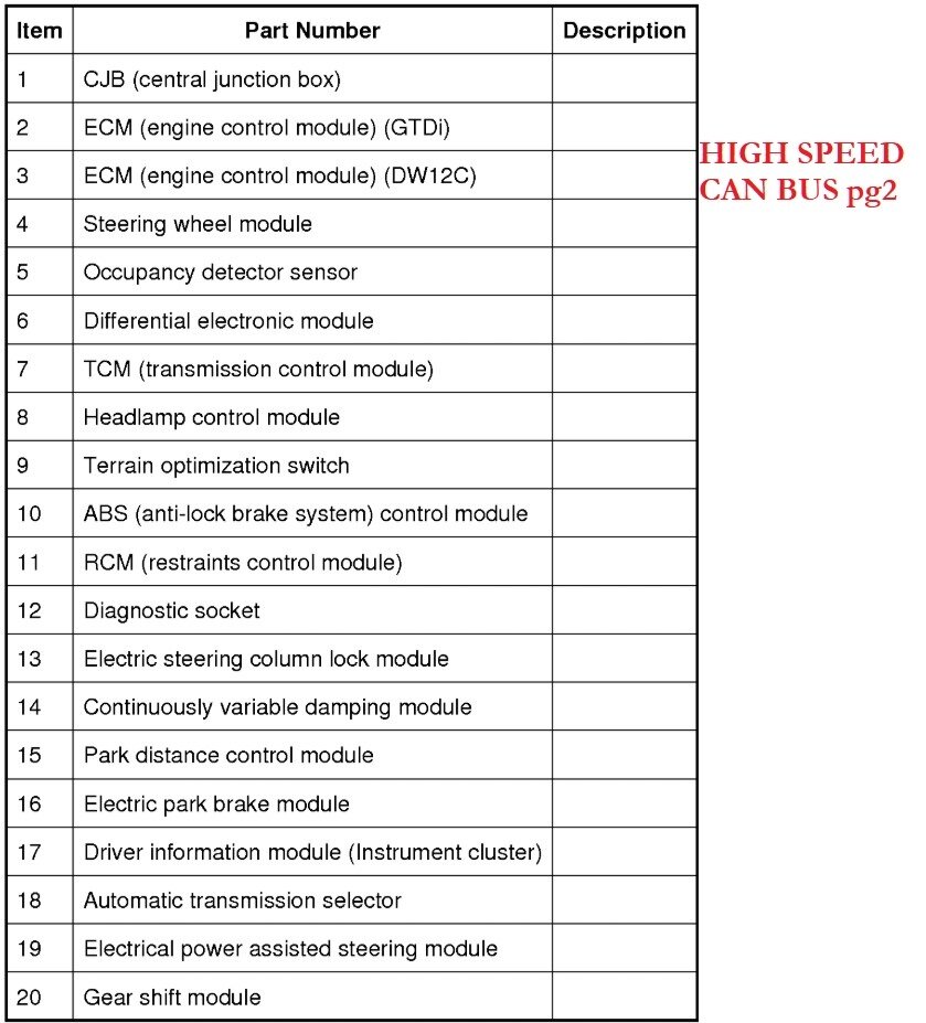

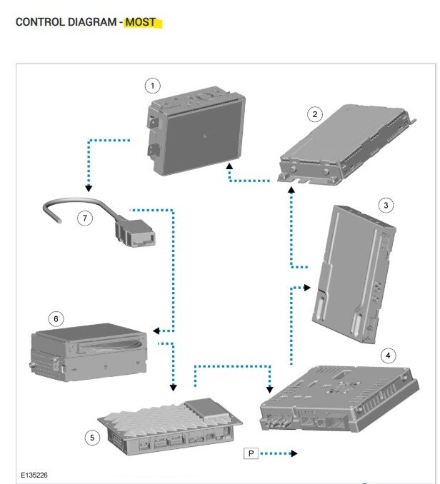

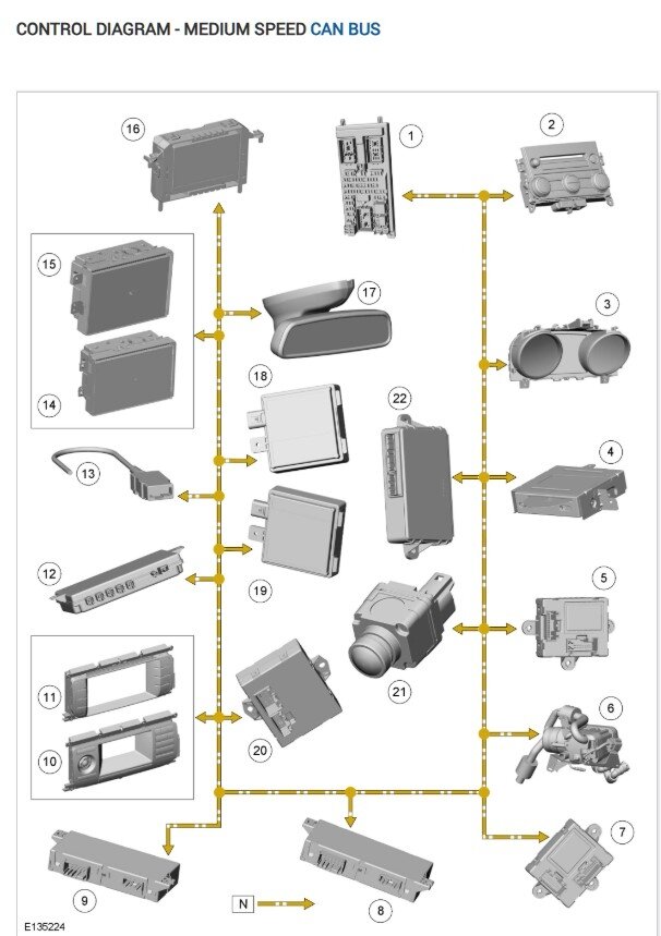

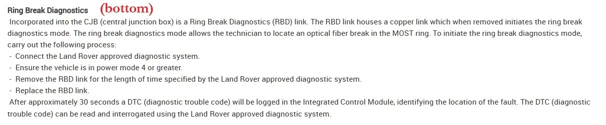

Would you like a list of all the modules on the High and Medium speed Can Bus? As well as the MOST Bus which is another entertainment network.

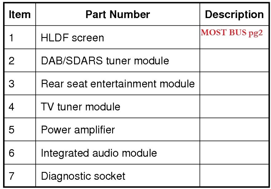

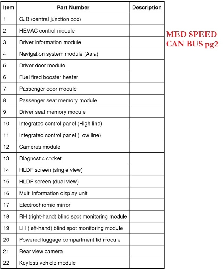

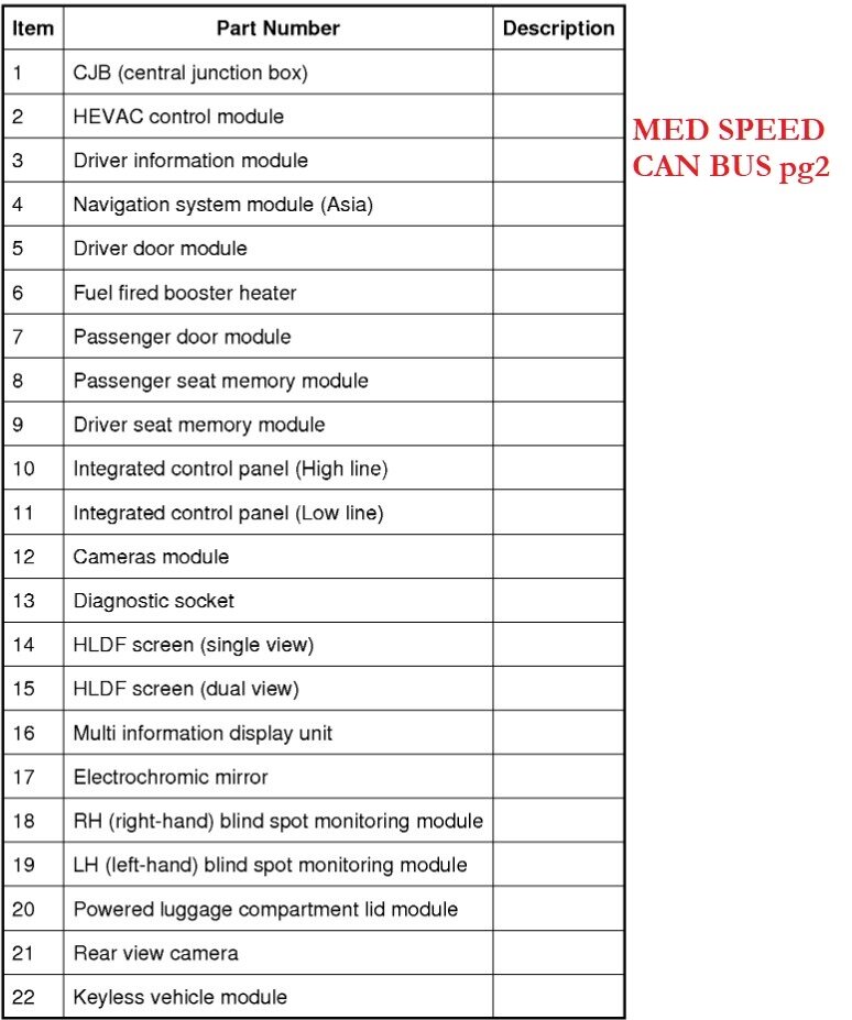

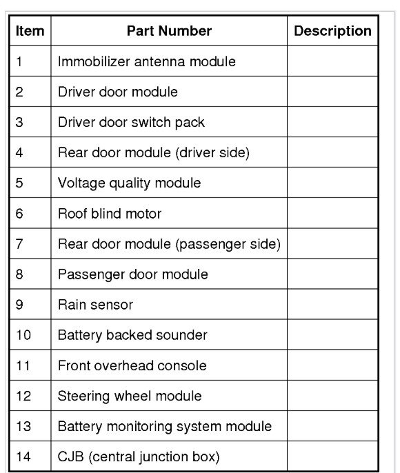

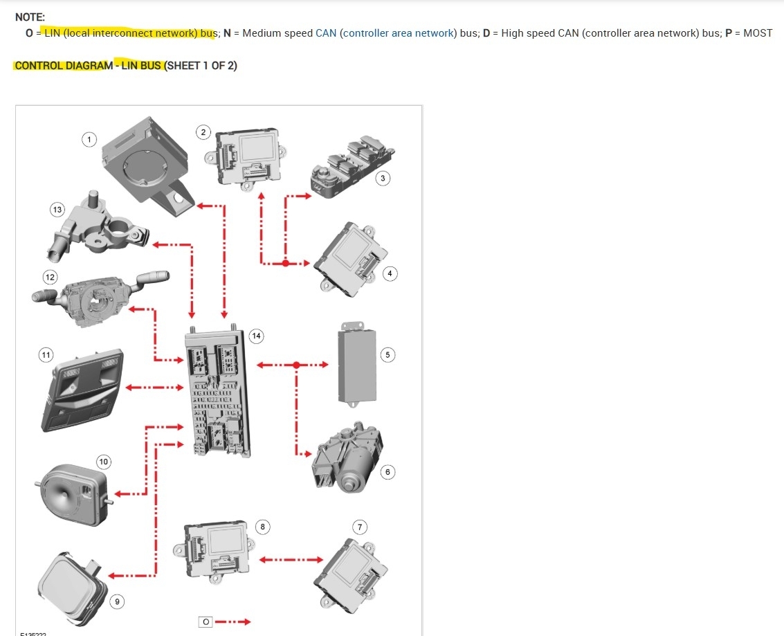

Ok these are the rest of the modules the vehicle may have. Diagrams 1-4 are all LIN Bus, then the other networks, (High Speed Can, Medium Speed Can, and finally the MOST Bus is the last 2 diagrams. Is there any specific module setting a Lin code? Because this vehicle has a lot of modules, thats for sure.
