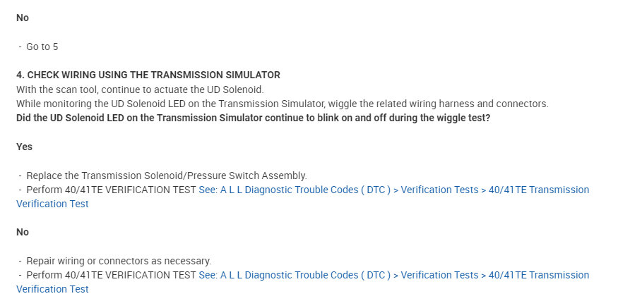

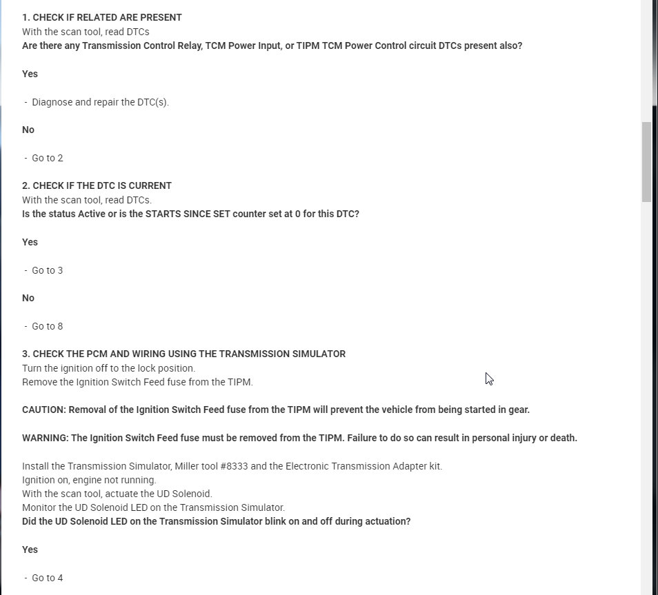

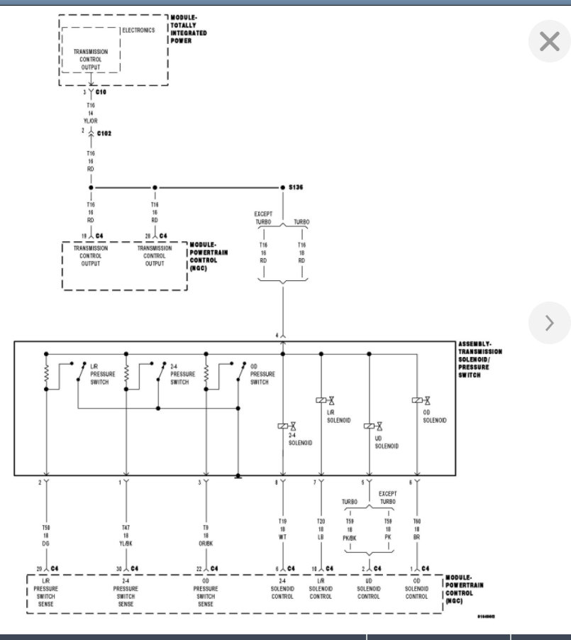

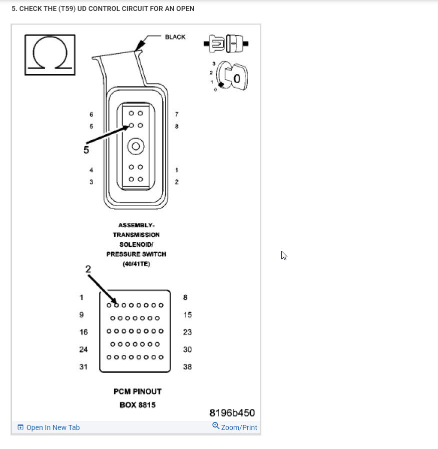

Vehicle listed above went into limp mode,threw two codes. first was generic for transmission control system, and problematic code was p0765 shift solenoid d. I dropped the pan changed fluid and filter, changed solenoid pack,erased all codes,upon test drive I got to second and threw the codes again back into limp mode. some say the wire harness could be bad some say the PCM is bad , others say valve body or control module inside. I'm so lost no other codes are throwing so it's solenoid related I'd think. any ideas? I've spent so much and going to lose my job if I don't get it fixed.
Apr 25, 2020 at 11:50 AM

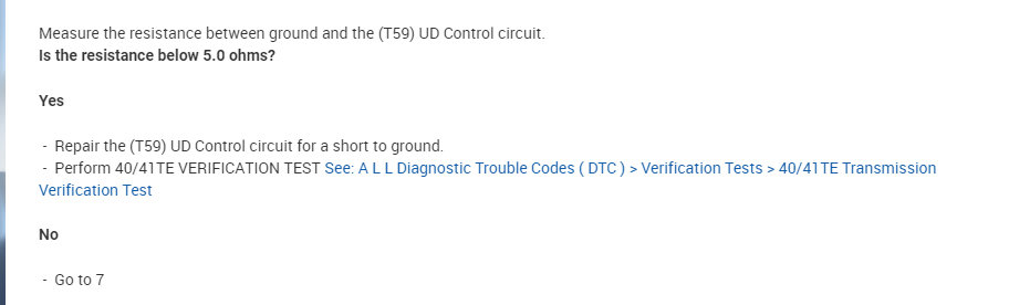

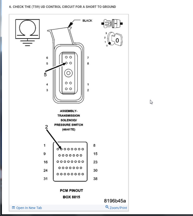

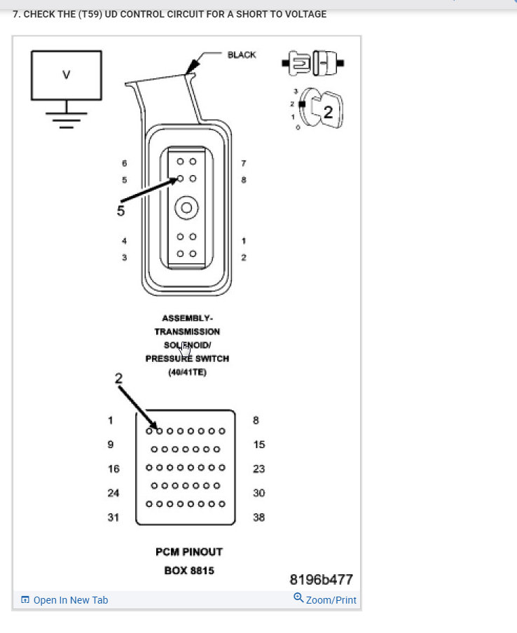

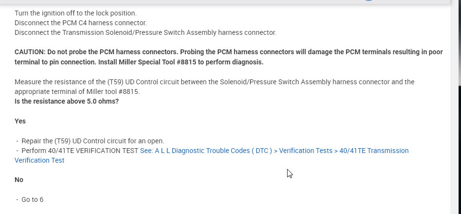

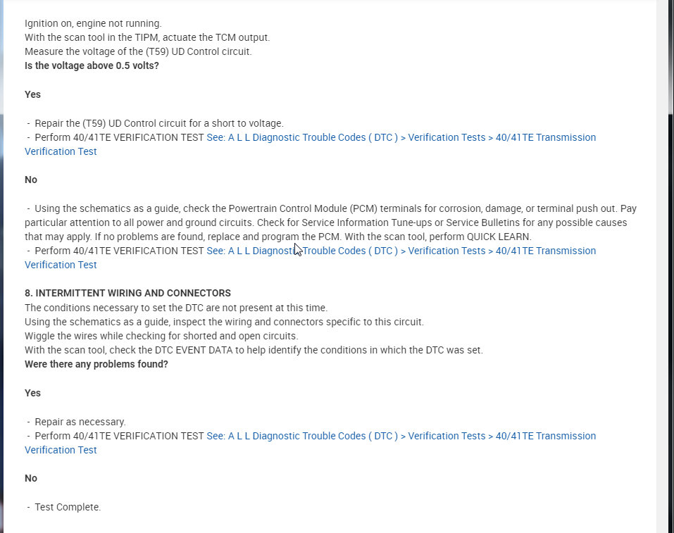

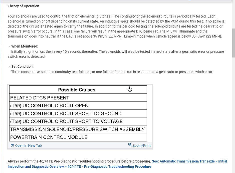

I am attaching the testing that we need to run through. As you will see there is a "Possible Causes" section that is pretty accurate on these situations. We need to eliminate wiring issues on the T59 circuit. If you replaced the solenoid then that leaves the PCM. However, I would not just replace the PCM without testing wiring first because I have seen many wiring issues causing these types of issues so we need to ensure that is not the issue.
Run through this testing and let me know what you find. Thanks
