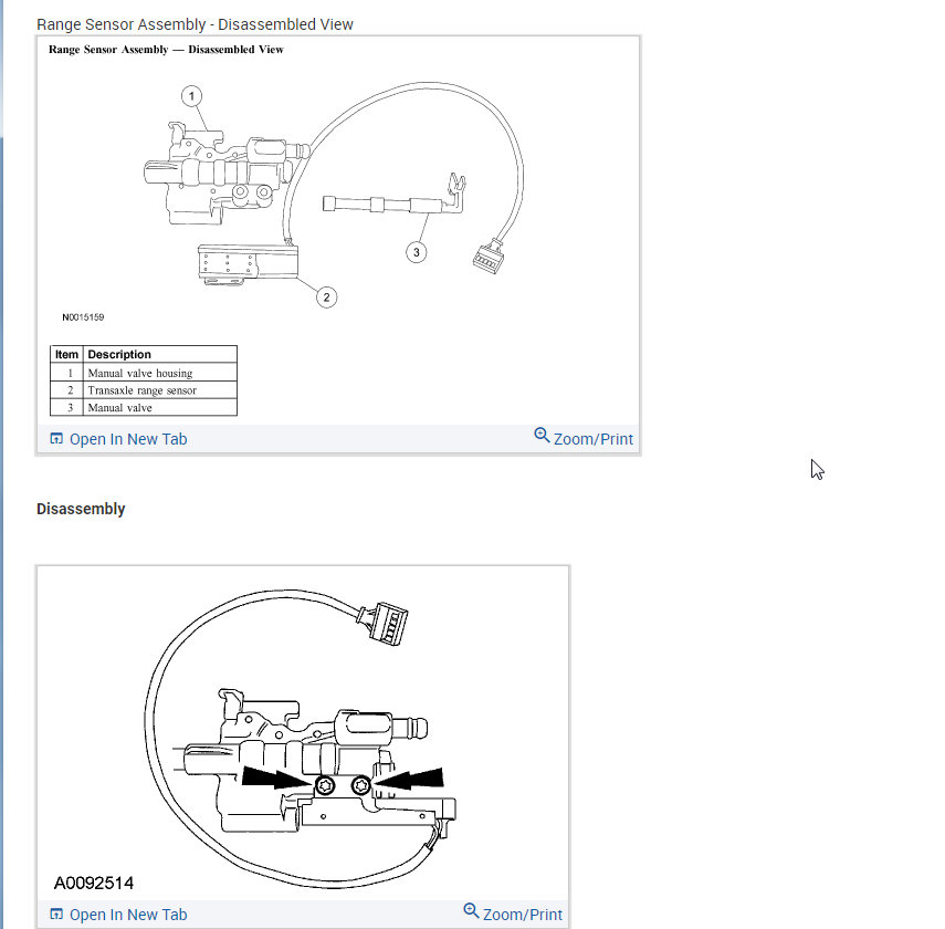

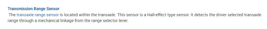

I am attaching some information on this TRS. If you have the CVT then the TRS is inside the unit and would require removing the unit. However, these are normally not the issue but just pointing to a greater issues so again, the code that you have will help us figure out what is needed.

I don't have the code. The mechanic who came out said his reader showed the TRS was bad. I have a rapidly sinking feeling that it's the whole mechatronic unit in the CVT. And yeah, I checked the VIN it's a CVT transmission.
Feb 16, 2021 at 9:23 AM
Okay. Thanks for that information. I would tend to agree that it is most likely internal to the unit at this point. Most people do not try and repair them as the cost to repair it is about the same as a replacement unit.
