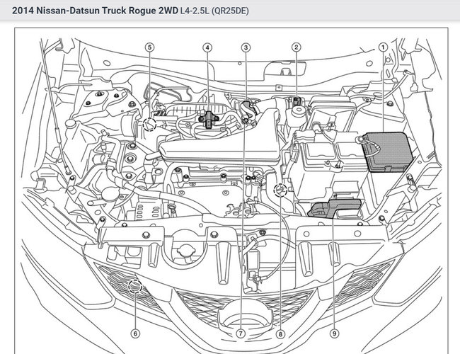

RPM tops out 2,500, reduced speed.
Sep 19, 2022 at 1:44 AM
  • 55,421 POSTS
This is common when the throttle body needs service. here is a guide to help show you what to do with instructions in the diagrams below to show you how on your specific car. Please go over the guide before you begin.
#3 is the location of the throttle body. Check out the images (below). Please let us know what happens.
