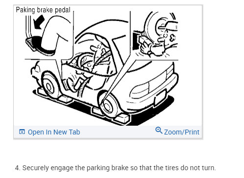

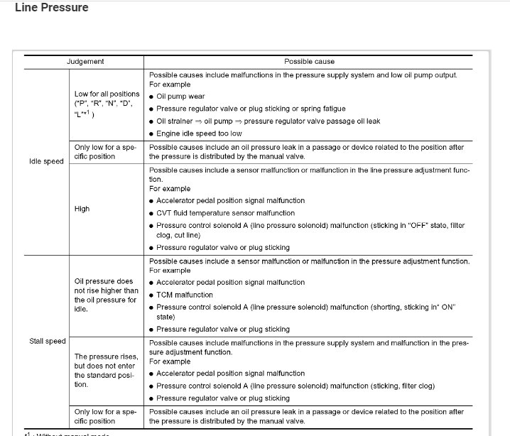

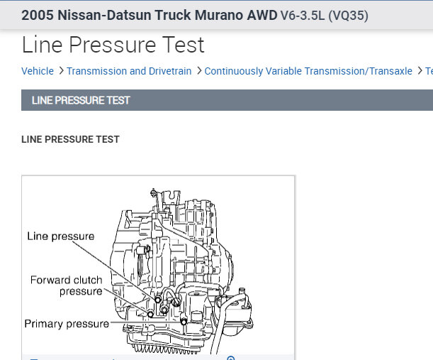

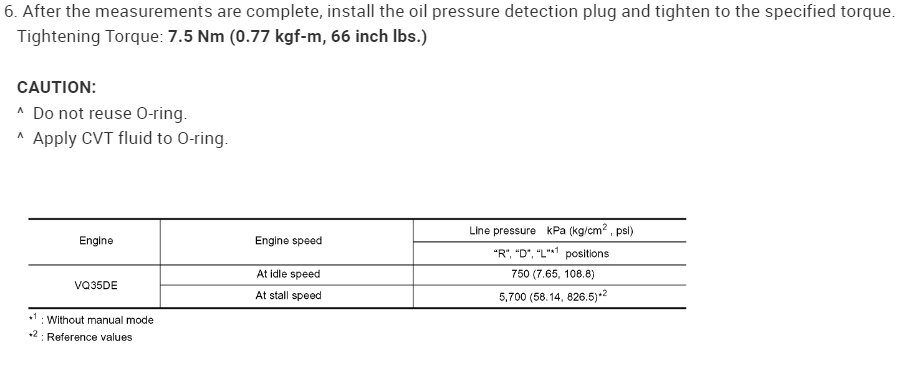

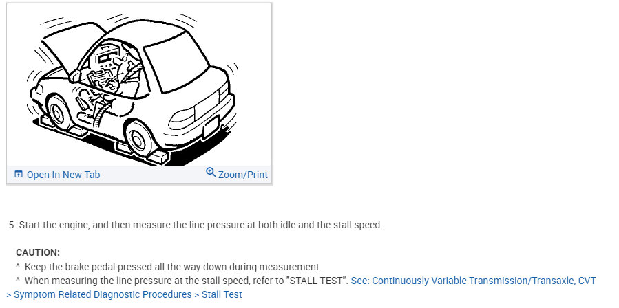

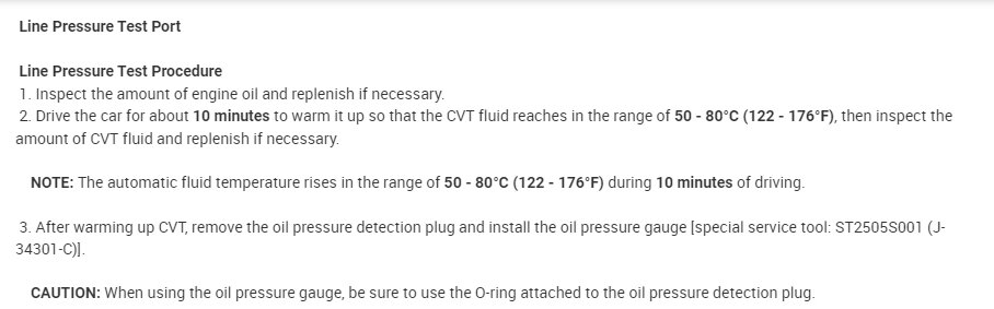

Also, is this the original transmission and how dirty was the fluid when you changed it? I ask because it could simply be a faulty transmission or there could be a line pressure-related issue. If you look below, I attached the tests for checking line pressure.
I've seen the transmission cooler become restricted causing low pressure. However, keep in mind with a CVT transmission, often times this indicates an internal problem.
