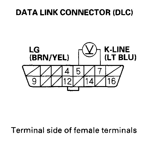

I was driving my car, and all of a sudden it bogged down and I was in limp mode. I also have a green key light flashing. We tried to hook up a code reader, but it wont link to any code reader. I also had a squeaking belt before hand and well as wheel bearing going bad. It will crank and run rough for maybe 3 or 4 minutes, then be just fine in idle.

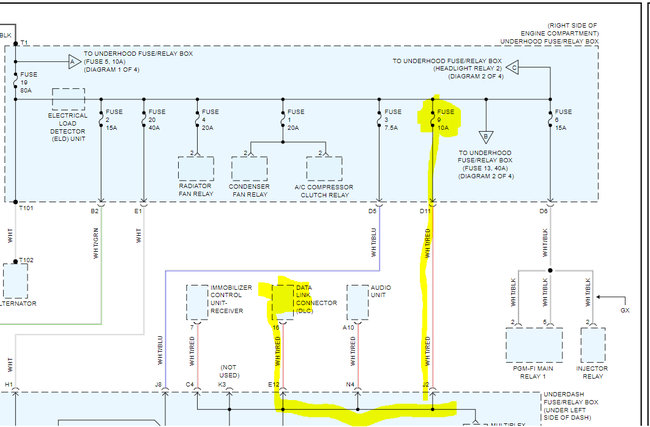

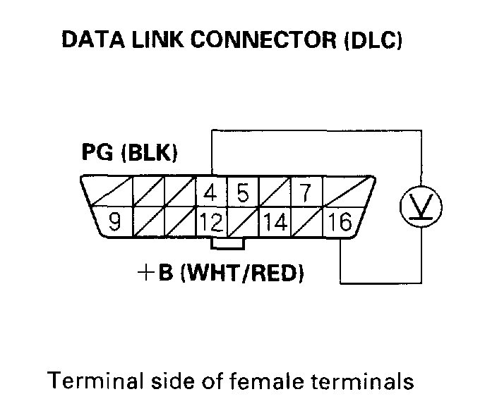

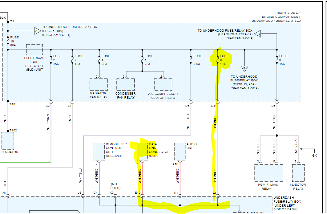

Before you start diagnosing the data link connector (DLC) to determine why you can't connect, check the fuse I indicated in the very last pic.
Here is a flow chart for diagnosing the data link connector. You may have lost power or ground to the port. The attached pics correlate with the directions.

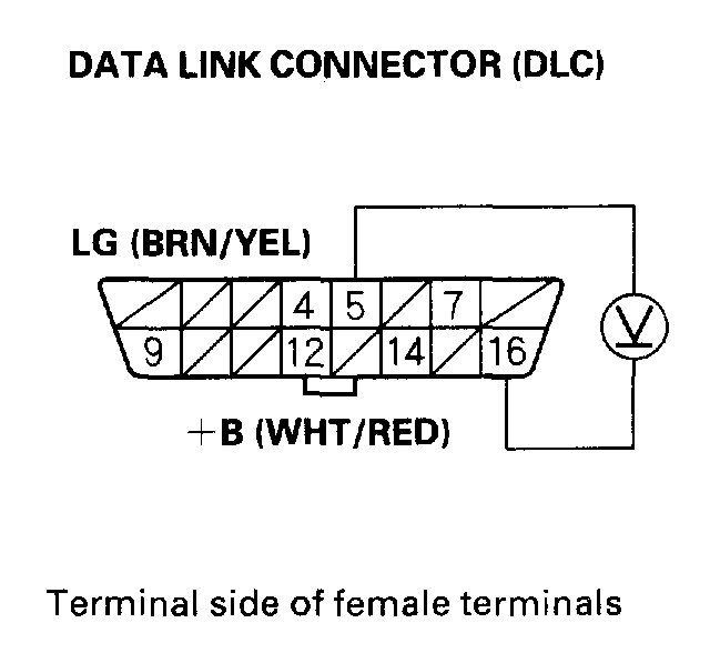

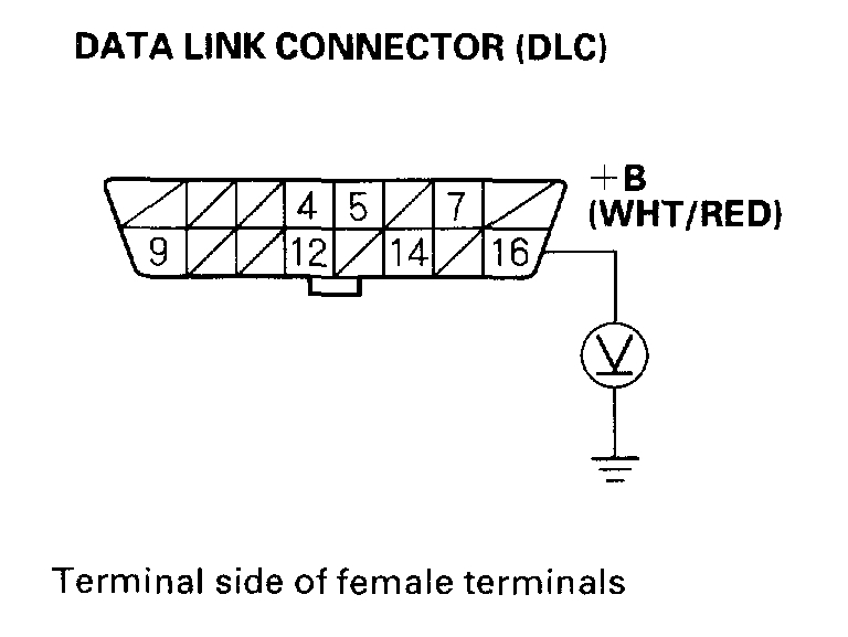

1. Measure voltage between DLC terminal No.16 and body ground.
Is there battery voltage?
YES - Go to step 2.
NO - Repair open in the wire between DLC terminal No.16 and the No.9 BACK UP (7.5A) fuse in the under-hood fuse/relay box.
pic 2
2. Measure voltage between DLC terminals No.4 and No.16.
YES - Go to step 3.
NO - Repair open in the wire between DLC terminal No.4 and body ground.

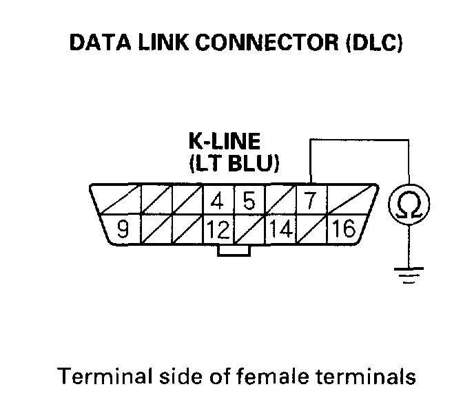

pic 3
3. Measure voltage between DLC terminals No.5 and No.16.
YES - Go to step 4.
NO - Repair open in the wire between DLC terminal No.5 and ECM/PCM (E3).

5. Measure voltage between DLC terminals No.5 and No.7.
Is there 8.5 V or more?
YES - Go to step 10.
NO - Go to step 6.

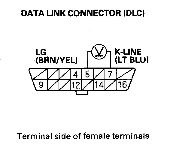

7. Disconnect ECM/PCM connector E (31P). Make sure the OBD II scan tool or Honda PGM Tester is disconnected from the DLC.
pic 5
8. Check for continuity between DLC terminal No.7 and body ground.
Is there continuity?
YES - Repair short to ground in the wire between DLC terminal No.7 and the ECM/PCM (E23). After repairing the wire, check the DTC with the OBD II scan tool/Honda PGM Tester and go to the DTC Troubleshooting index. See: A L L Diagnostic Trouble Codes ( DTC ) > Diagnostic Trouble Code Descriptions
NO - Go to step 9.

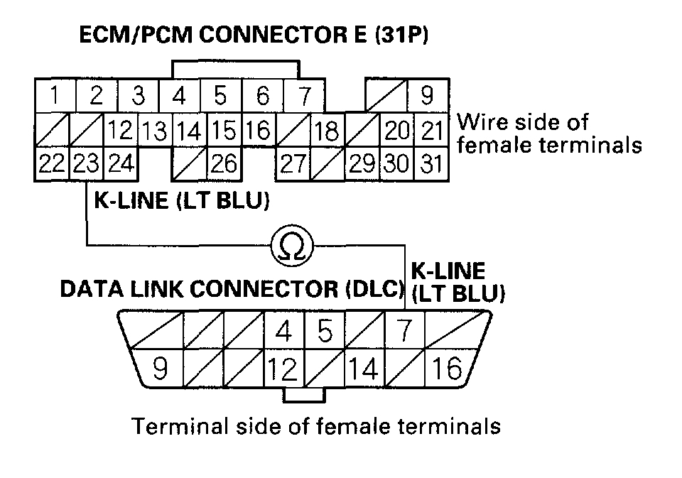

pic 6
9. Check for continuity between DLC terminal No.7 and ECM/PCM terminal E23.
YES - Update the ECM/PCM if it does not have the latest software, or substitute a known-good ECM/PCM, then recheck. If the symptom/indication goes away with a known-good ECM/PCM, replace the original ECM/PCM.
NO - Repair open in the wire between DLC terminal No.7 and the ECM/PCM (E23). After repairing the wire, check the DTC with the OBD II scan tool/Honda PGM Tester and go to the DTC Troubleshooting index. See: A L L Diagnostic Trouble Codes ( DTC ) > Diagnostic Trouble Code Descriptions
