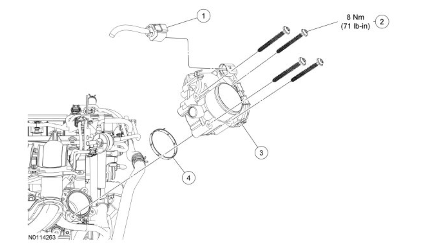

It didn't say if they run the codes so lets do that first .here is a guide to help you to me it sounds like the throttle body needs replacement. here is a diagram below and a guide to help us fix the problem.
and
https://www.2carpros.com/articles/reduced-power-limp-mode
Removal and Installation
1. Remove the Air Cleaner (ACL) outlet pipe. For additional information, refer to Section 303-12 .
2. Disconnect the electronic throttle control electrical connector.
3. Remove the 4 bolts and the Throttle Body (TB).
- Remove and discard the TB (Throttle Body) gasket.
- To install, tighten to 8 Nm (71 lb-in).
4. To install, reverse the removal procedure.
- Install a new TB (Throttle Body) gasket.
5. If the TB (Throttle Body) was replaced, turn the key ON without cranking the engine for 1 minute to allow the PCM to learn the adaptive table values for the new TB (Throttle Body).
