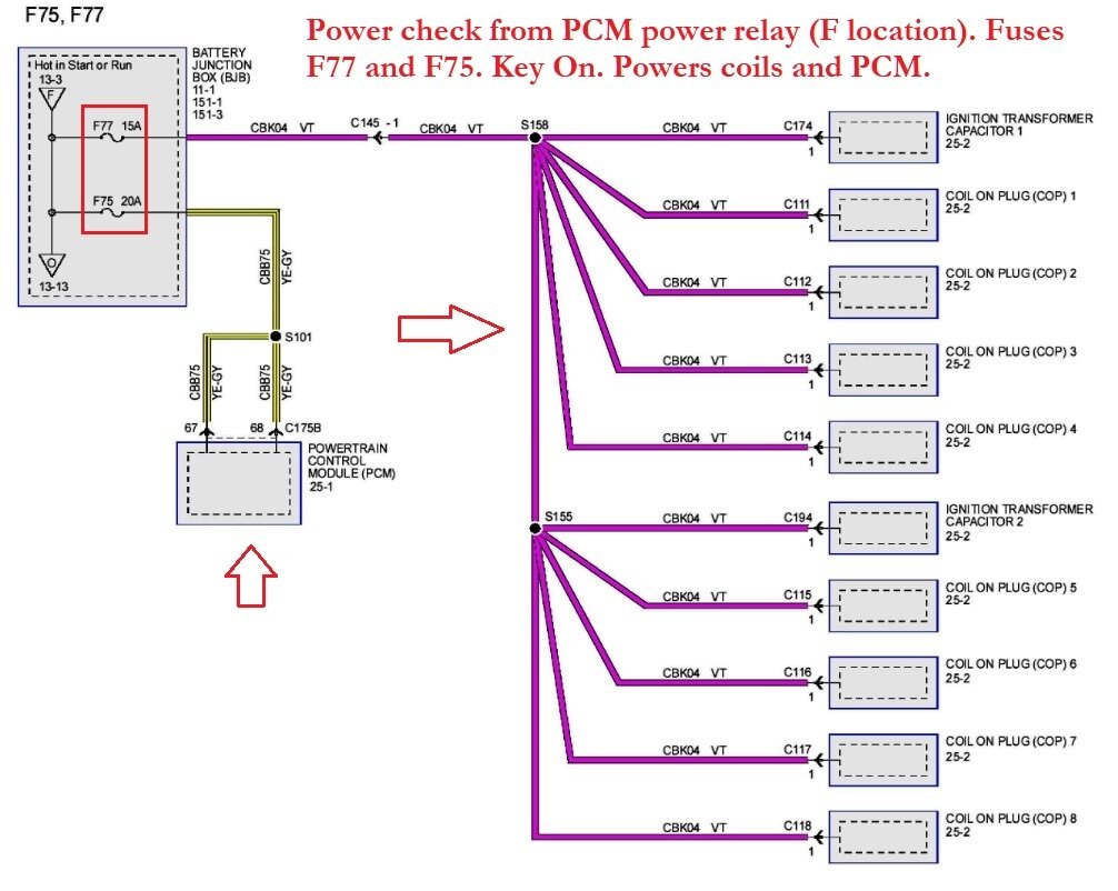

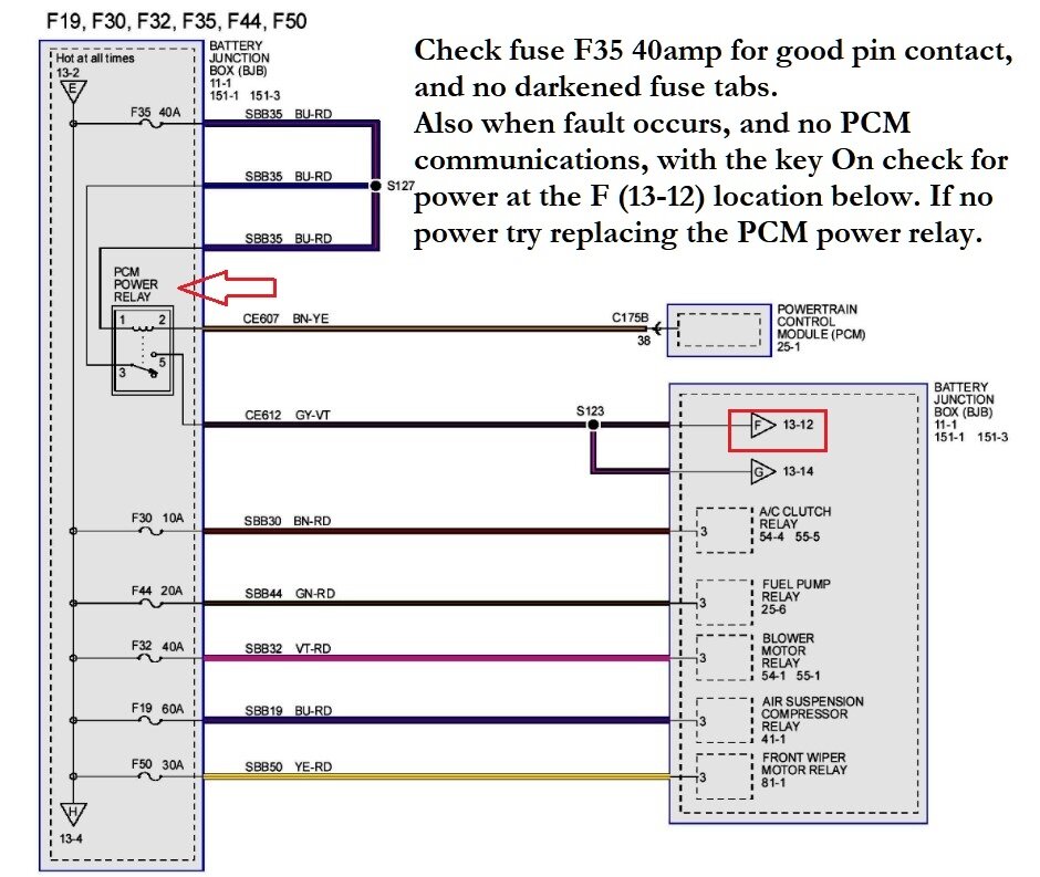

Diagrams 1,2 are for checking if the PCM power relay during the fault, showing the fuses that should have power with the key On.

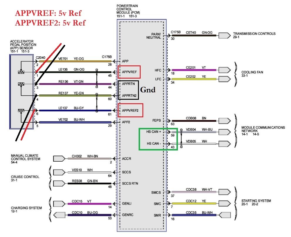

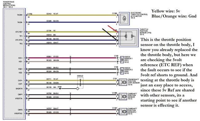

Diagrams 3,4 are checking the throttle position sensor's 5volt reference (because it's easy to get to) and the APP sensor on the gas pedal. During the fault, check with the key on that these sensors have 5volts on labelled wires, a shorted 5v reference can cause the PCM to go down.
You should be able to see the APP (gas pedal) movement in the live engine data on your scan tool, key on, pressing the pedal you should see it sweep from 0-5volts or 5-0volts with no dropouts in the signal.

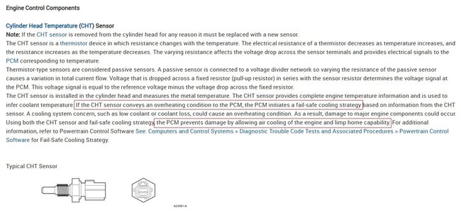

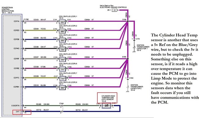

Then diagrams 5,6 are the Cylinder Head Temperature sensor, which can also cause the PCM to go into Limp mode to protect the engine from overheating.
the intermittent PCM no communications issue might be a power loss, in which case I would check the PCMs powers and grounds to make sure they are ok, but here's some starting points and things to check with a multimeter. If the PCM still communicates go into the live data and see if anything looks out of place, like a high engine temperature, but post the codes you have seen set as well.
If you don't see anything that looks questionable, we can see if the PCM is losing power. The turning the engine off and it won't restart statement sounds like something is getting hot and faulting, then cooling off allowing a restart. Check the relay pins and fuses for signs of overheating, they can be pretty obvious, looking semi melted or having dark pins. Let us know what you find, and we will go from there.
