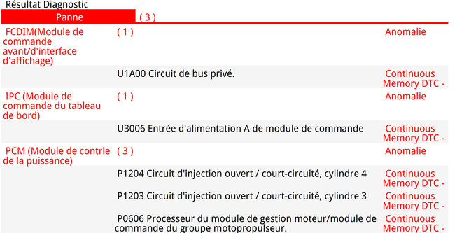

So I finally managed to get the codes from the mechanic they are as follows (the report is in french so I will just give you the codes for now, if you need more please let me know.
FCDIM - U1A00
IPC - U3006
PCM - P1204 / P1203 / P0606
The mechanic has mentioned that he is going to try to move the injectors around and then see if he gets the same fault, that should confirm if its an ECU problem? I have attached the report, but it is in French, if you have any ideas, or think we could be doing anything else, its been 3 years now and I would like to just get it running so I can sell it and buy a car that runs, lol.
Thanks for any help I really appreciate it!
Verity
Aug 30, 2020 at 4:49 PM
  • 110,240 POSTS
Based on the codes, you have a couple issues happening. However, I feel you need to start with the P1203 and 1204. Those codes indicate there is an issue with the injectors in cylinders 3 and 4. Has anyone done anything with the injectors at this point?
If nothing has been done, have your mechanic clear the codes and then see if the P0606 returns. If it does, in most cases that indicates an internal fault from the PCM which would require testing of that module.

We changed all 4 injectors last year, the car has not been driven since as we got half way home and it went into limp mode again so it went straight back to the mechanic, since then it has gone to a new mechanic as the previous one has ben ill and has changed location. When we changed the injectors (for reconditioned as it was too expensive to purchase 4 new) we also changed the fuel injector leak of return pipes, injector seals and washers.
The plan at present is to switch injectors 3 and 4 with 1 and 2 and then see what the computer read says, from there if it still picks up 3 and 4 we will know it is an PCM issue, at least that seems to be the idea? what do you think of this idea? of course this will cost more again to remove and switch the injectors around but at least we might get a final answer?
