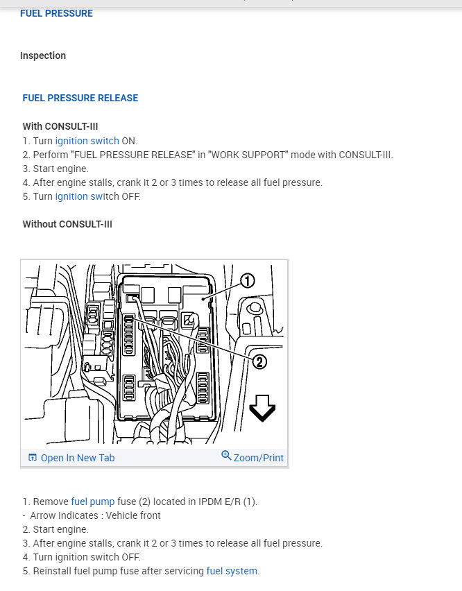

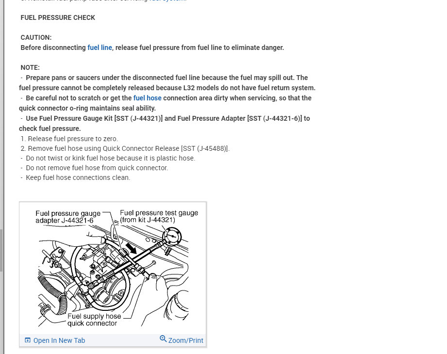

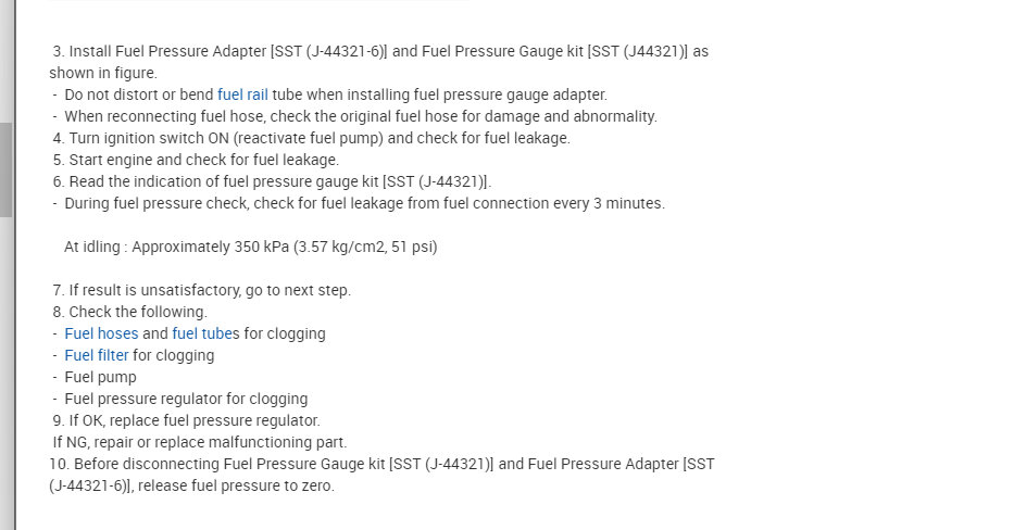

Okay. This means the theft system is turning off so that is a good thing.
Next thing to check is the fuel pressure. I am not sure why it will start if the battery is unhooked but we need to just start crossing more things off the list and a start and stall is also caused by a fuel pressure issue.
Here is a guide that will help with this:
I attached the process from the manual that will give the detail needed. Let us know what you find with this, and we can determine next steps.
Thanks
