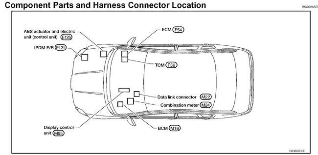

Can Someone Please Tell Me Where The Ecu Is Located?
Apr 24, 2013 at 12:57 PM
JDL
  • 16,098 POSTS
The engine control module is located behind the glove box next to the TCM here is a diagram below to show you. Check out the diagrams (Below). Please let us know if you need anything else to get the problem fixed.

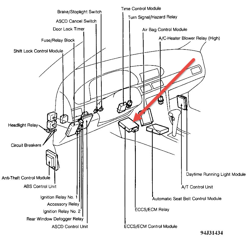

I need to locate the ECU unit. Thanks
Jan 22, 2019 at 6:13 PM (Merged)
HMAC300
  • 48,601 POSTS
if you are having a problem with engine running you should scan for codes and check fuel pressure as it may not be the ECU. See picture for location and see link for fuel test.
RENAV
  • 9 POSTS
Thank you for the info you provided, but we had professionals look at it and they said it needed to be replaced. I'm not going by my car inexperience just to assume that's what it is. I just need help in finding its location so we can replace it.
Jan 22, 2019 at 6:14 PM (Merged)
HMAC300
  • 48,601 POSTS
you can it should. be plug and play just don't bend any pins and if a prom unit inside old one put in new one

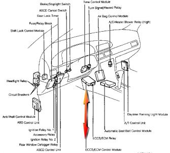

Where is the computer locates at? How does it look,
SERVICE WRITER
  • 9,123 POSTS
https://images.2carpros.com/forum/automotive_pictures/30961_pcm_2.jpg
