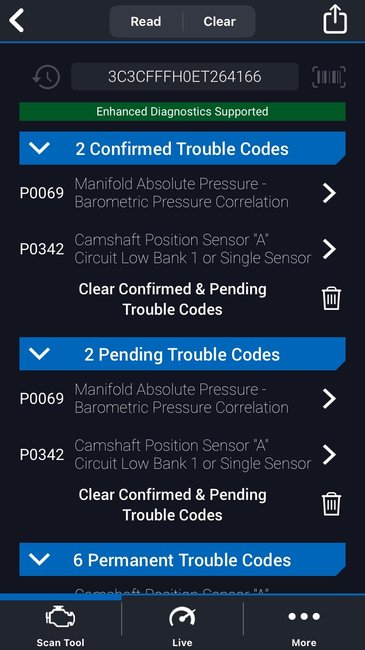

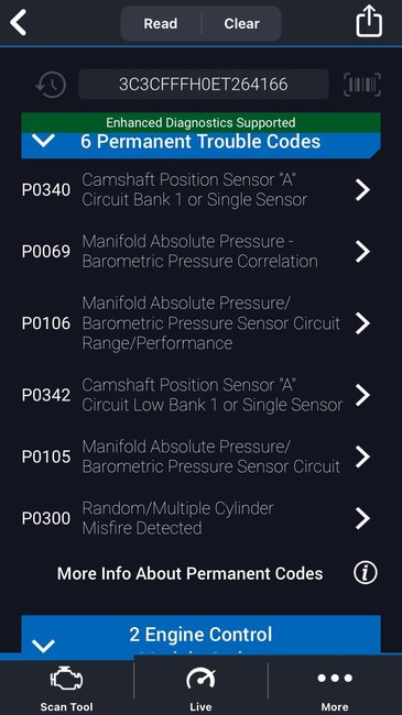

Okay. Put the car back together and drove it about 6 miles and returned and hooked the reader to it. The codes by the cars internal computer were
P0069 and P0342. The code reader threw the same two codes under confirmed trouble codes and pending trouble codes. It also threw under permanent trouble codes
P0340, P0069, P0106, P0342, P0105, and P0300. The codes P0069 and P0342 I thought I fixed. But evidently not. Of course the check engine light is still on steady.

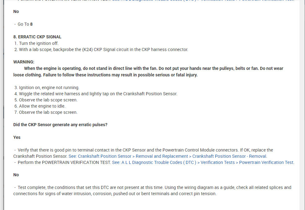

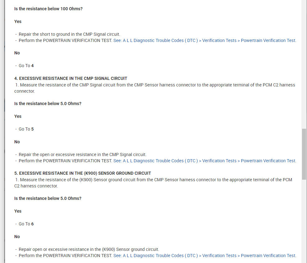

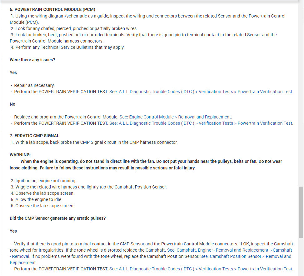

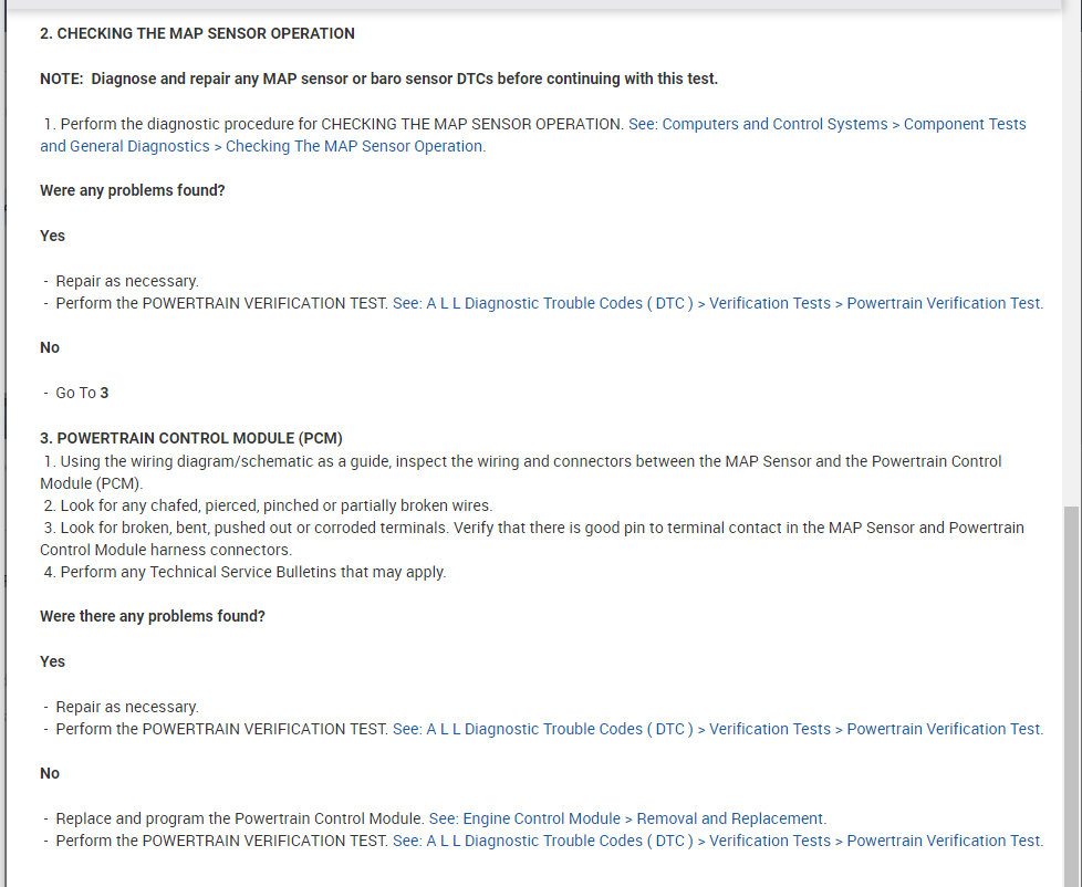

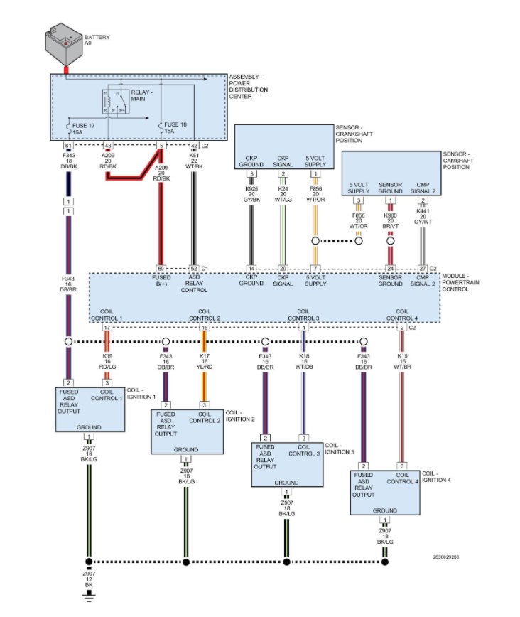

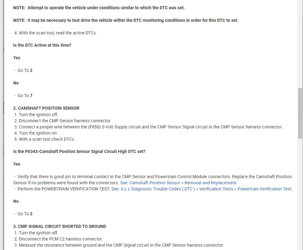

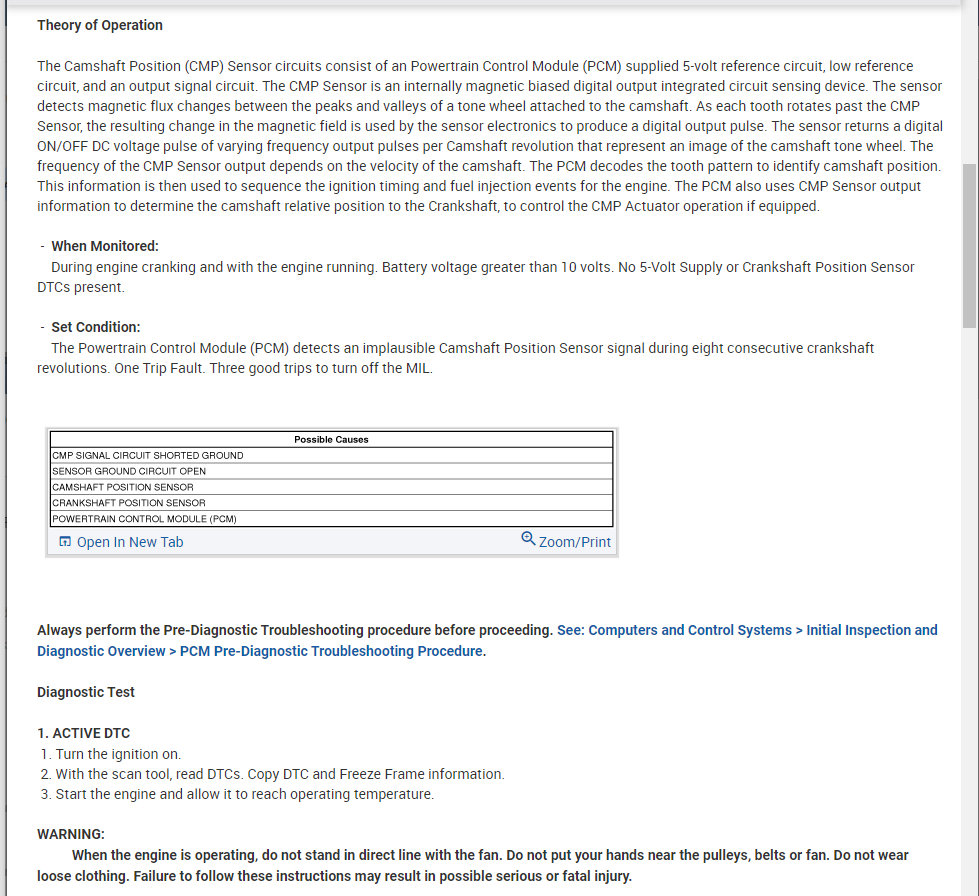

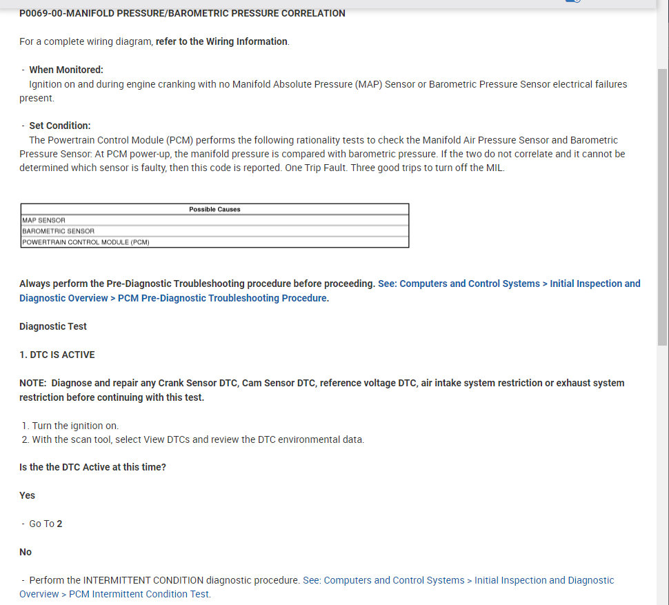

That is good info. I attached the testing that we need to run through in order to find out what the issue is. However, it is most likely a PCM as that is what they all have in common. I would go through the testing because they are not cheap enough to just take a shot at it.
Please let us know if you have questions. Thanks
