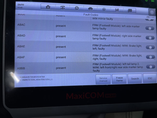

Have several codes that may or may not be tied up to each other. Car will sometimes start from first time sometimes takes 10 times before it does, it will continue to crank but not start. Since it dos it is in limp mode, idle is fluctuating on its own up and down, and no throttle response. I suspect the relay code is the main one to look at, any ideas where to start and where this relay is?

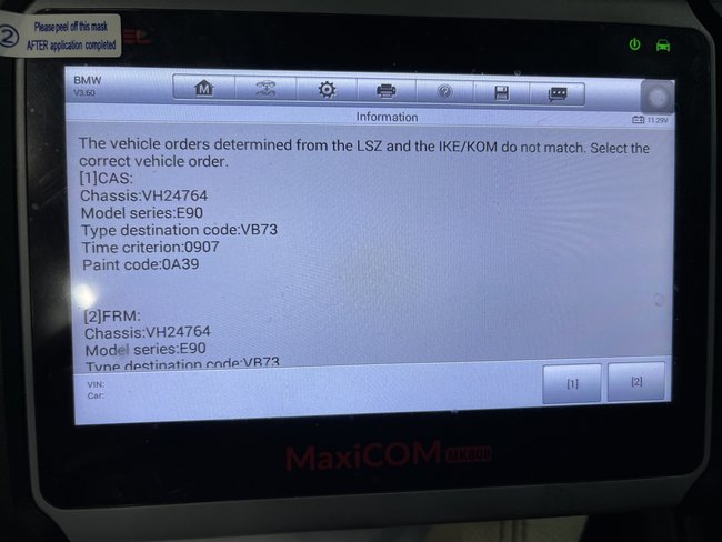

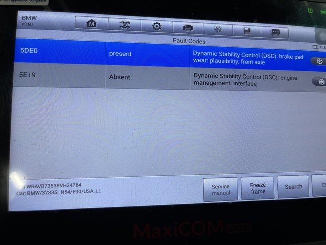

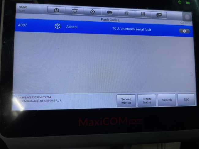

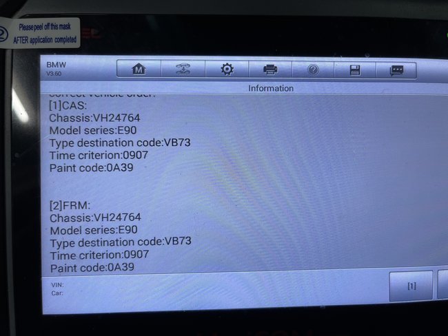

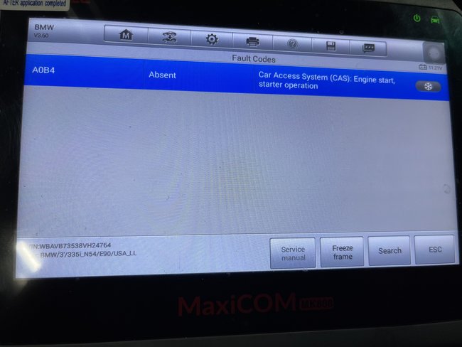

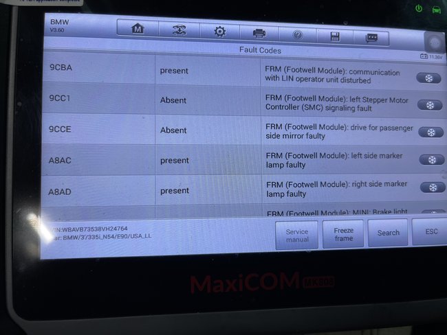

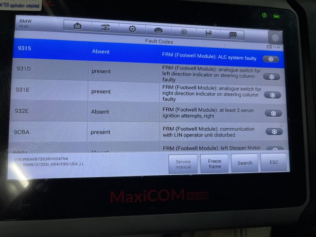

Even though the car does not struggle when i try to start it i just noticed it says 11.25v. Am gonna tickle charge it and see first. Plus am sure many of these codes are related or related to the low in battery charge. But here they are. First pic shows what the scanner asked me. I have never see this before, but both options are exactly the same.
I started the car after I deleted all codes after the can scan but the engine code is persistent and didn't go away. As soon as you start it there is a message of reduced power and the rom just revs on its own. Also the voltage is 13.8 when it started. As soon as i turned it off it started to drop to 11.40v.

Hello again.
Yes, 11.25V is too low for your car to function normally. The minimum voltage is usually 12.5 for normalcy. I would perform a charging system test first. Verify the alternator is outputting around 13.5-14.5V and your battery is in good condition. If the voltage keeps dropping on the battery when car is shut off it might not keep holding a charge. Here are a few tutorials for batteries:
https://www.2carpros.com/articles/how-to-charge-your-car-battery
https://www.2carpros.com/articles/symptoms-of-a-bad-car-battery
First thing I would do is perform a battery load test to see if it will hold a charge. Most local auto parts stores will do this for free. Get back to us with the results and we'll go from there. Hope this helps and thanks again for using 2CarPros.
