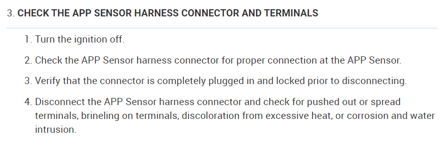

Vehicle stuck in limp mode?
2011 JEEP COMPASS
178,000 MILES • 4.2L • 4WD • AUTOMATIC
DAVIDLOCK

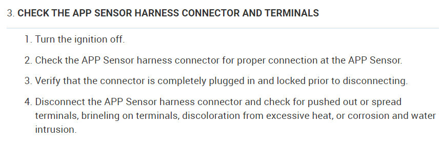

I have done some research and I replaced the throttle pedal first and it didn't fix anything. Then I replaced the throttle body and that hasn't fixed anything.

Do you remember the code number? If the car is in 'limp mode' then there is a fault code stored in the vehicles computer. Here is a tutorial showing how to check for diagnostic codes:
Once you perform this get back to us with the code information and we can then properly diagnose and give you advice and repair guides. Hope this helps and thanks for using 2CarPros.

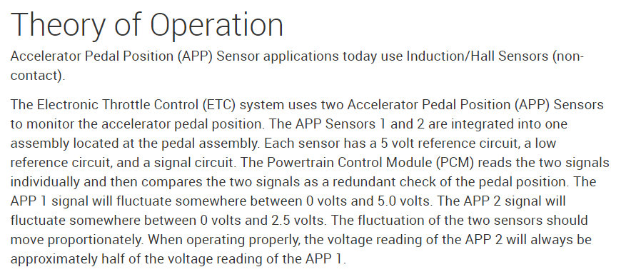

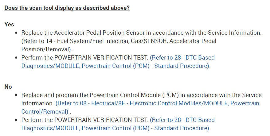

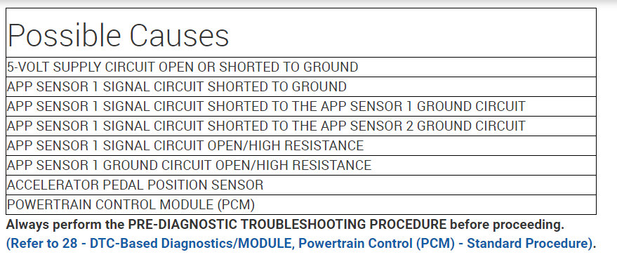

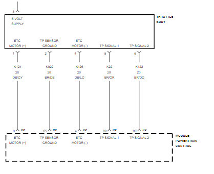

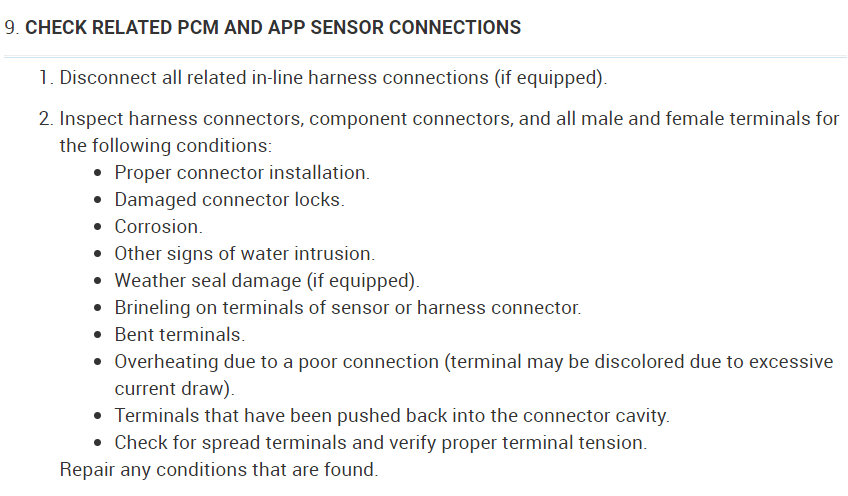

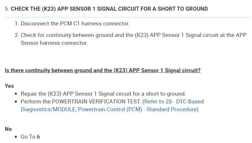

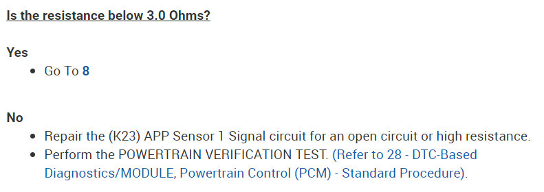

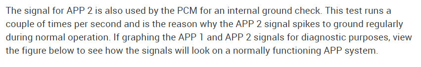

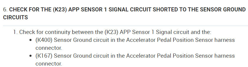

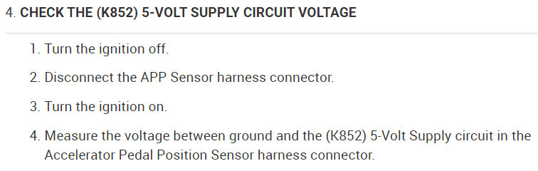

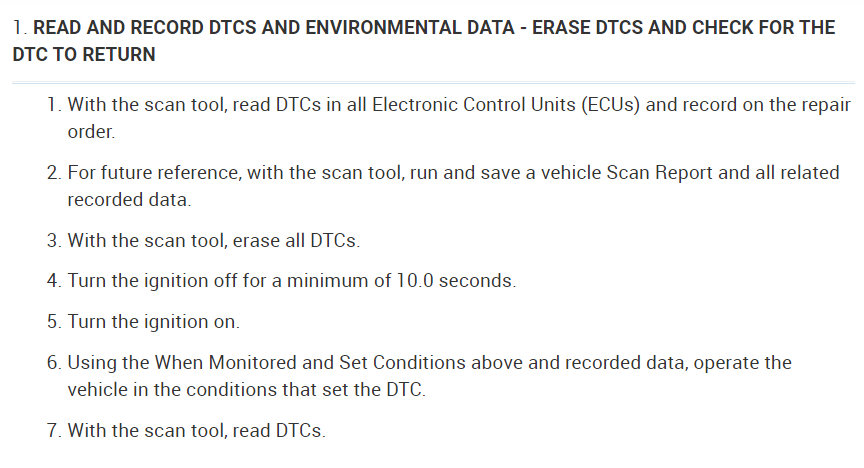

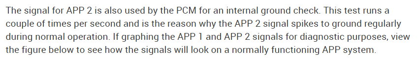

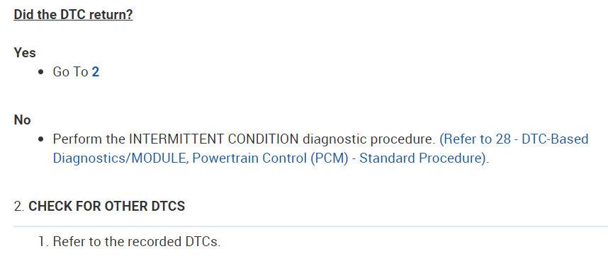

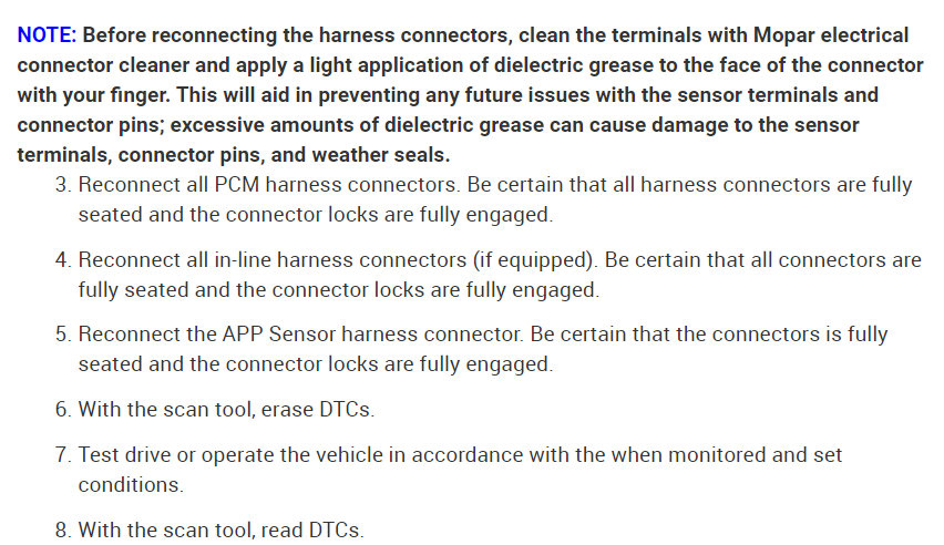

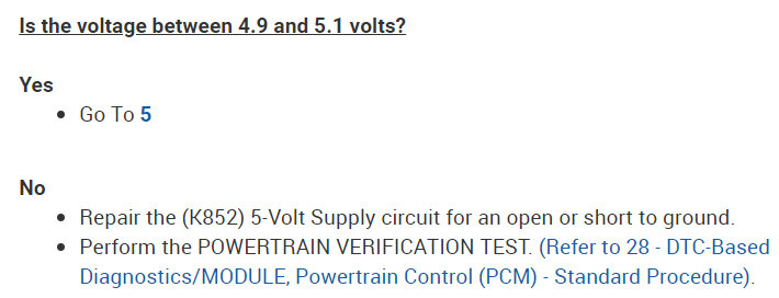

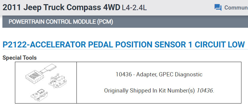

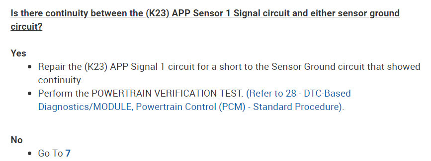

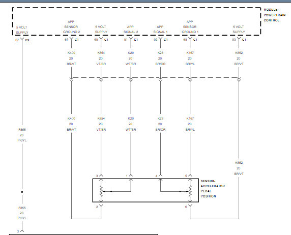

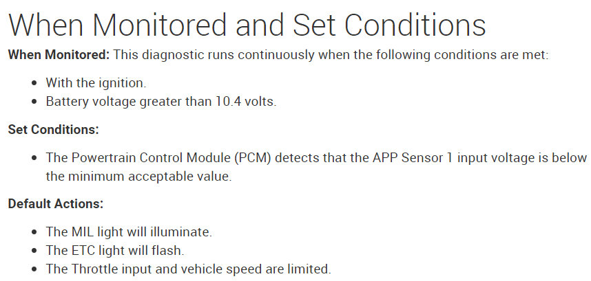

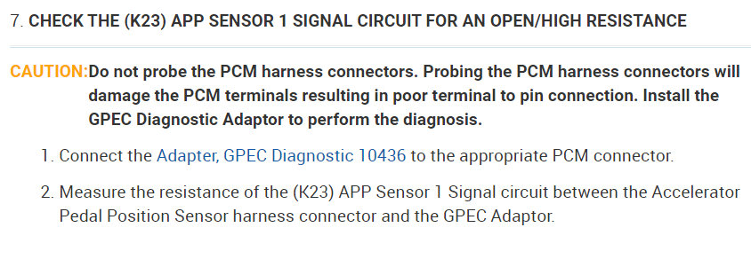

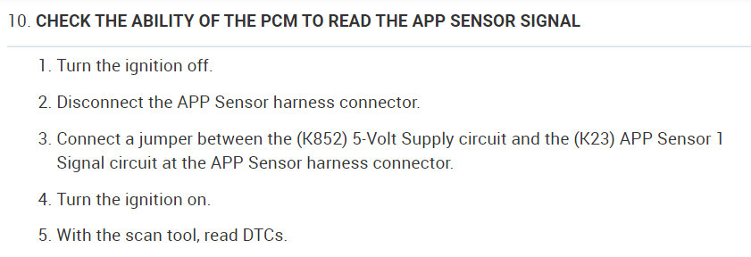

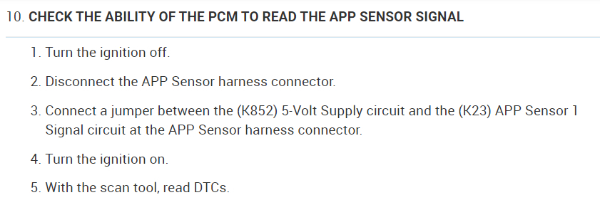

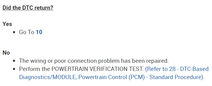

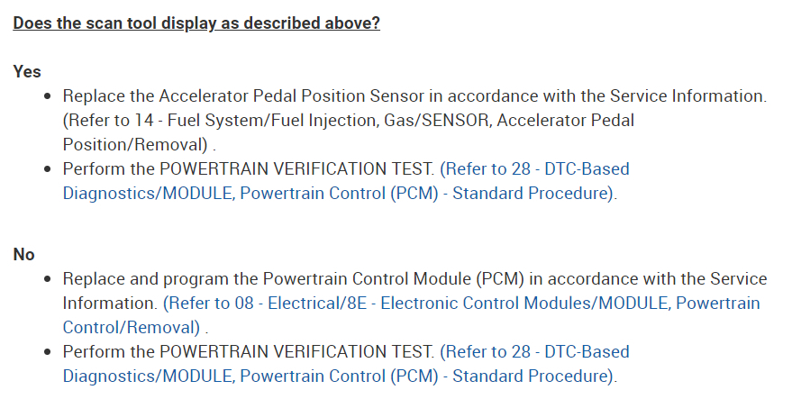

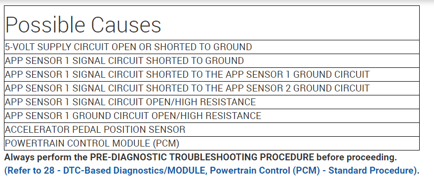

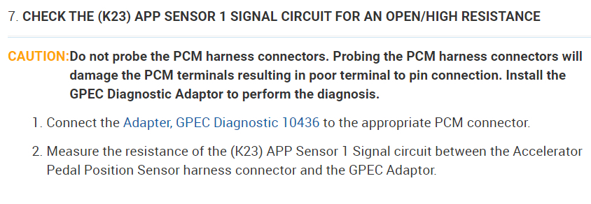

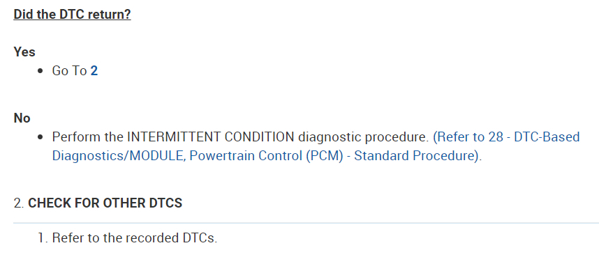

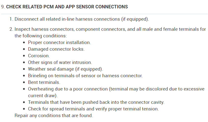

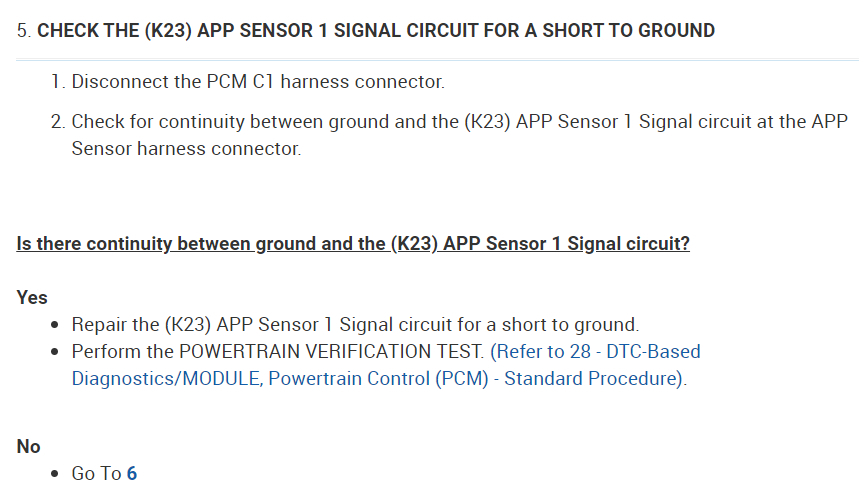

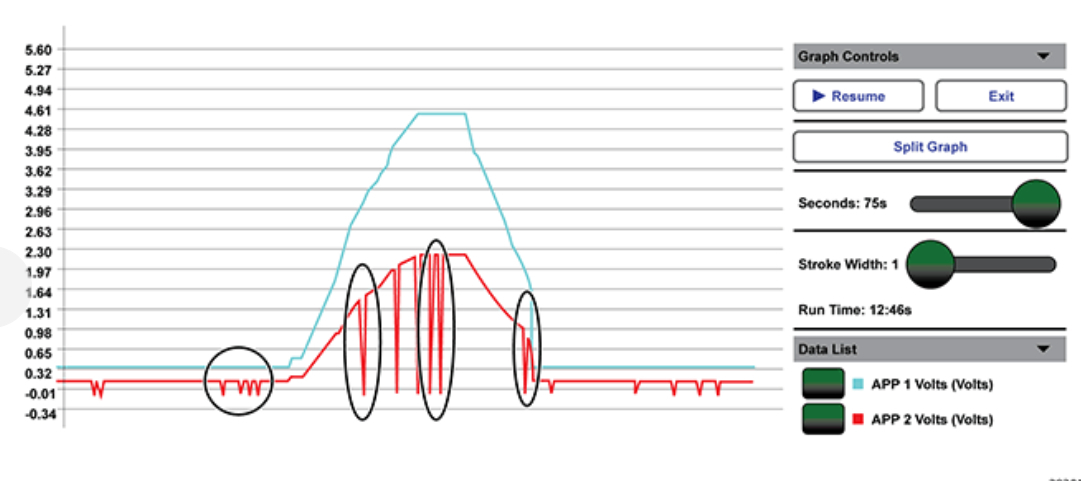

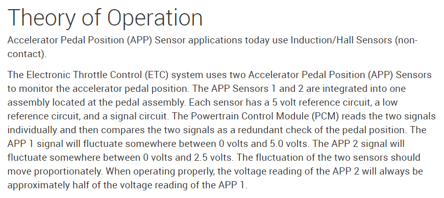

I have checked the codes and the code is p2122.
Dec 22, 2020 at 1:49 PM
DANNY L
  • 5,648 POSTS
Hello again.

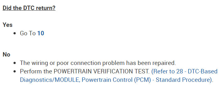

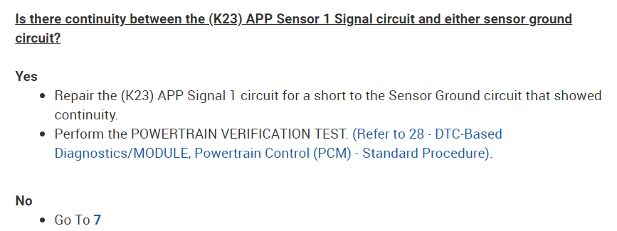

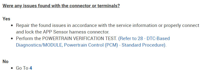

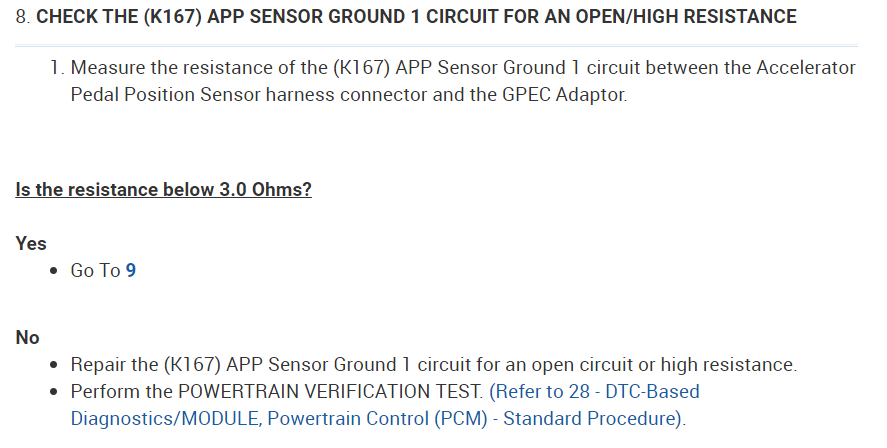

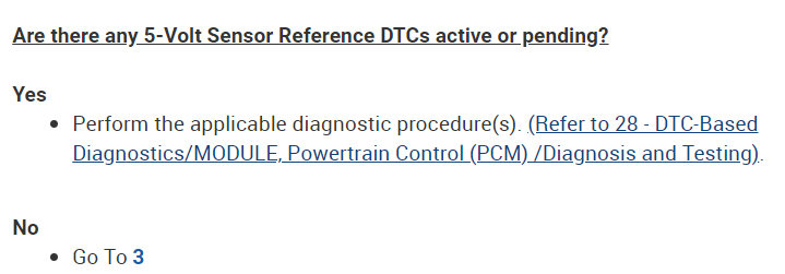

Here is information for code P2122. I've attached diagnostic picture steps below for your vehicle. Let us know what you find and get back to us. Hope this helps and thanks again for using 2CarPros.
Danny-
