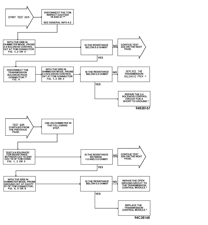

Rather than try to retype everything, I got these instructions from Mitchell ProDemand. I didn't read through everything, but I recognize the drawings as being from a Chrysler diagnostic manual. See how far this gets you.

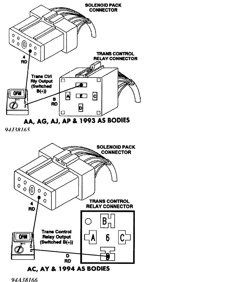

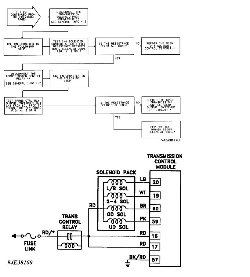

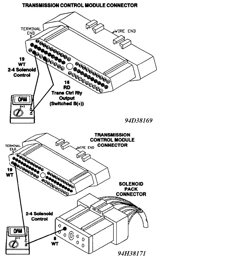

ok i started test 22a it states probe the 2-4 solenoid control ckt. what is ckt ?at tcm connector.it doesnt say with key on or off. i'm assuming it doesnt matter either negative or positive to either 47 or 19it reads infinity (open) thats considered obove 5 ohms correct ? then tested 2-4 solenoid betewwen cavity16 and 19 and that reads infinity(open).then tested between cavity 19 at the tcm connector and pin 8on the sonenoid connector and that read below 5 ohms. then i removed the trans control relay and was going to test for resistance as in the diagram but i remembered pin D in the diagram is hot all the time ? how can resistance be tested if its hot ?? dont understand this. the ohm meter will fry. can you please explain this ?

"Ckt" is "circuit". When you have a diagnostic fault code, they always refer to the entire circuit, never just a single part. in this case, you're testing a solenoid along with all of the wiring, at the same time. When you get acceptable results, you're done, and you can move on. When you get an open circuit, meaning an infinite reading, you need to narrow it down to a break in a wire, a corroded connector terminal, an open solenoid coil, or, as I often do, a bad connection of the meter's probe.
When testing a solenoid circuit, a typical resistance reading will be around one or two ohms, (almost a dead short, meaning 0 ohms). There will always be a little resistance in the wires, and in your meter's leads. Don't get excited if you find six to eight ohms. It's the open circuit you're looking for. "Open" means there's a break somewhere. Resistance values can always go higher and higher, but if you're using a digital volt / amp / ohm meter, 20 meg ohms, (20 million) is the highest most meters will read. LONG before you get anywhere close to that, the circuit will not work because not enough current can get through. Even though the actual amount of resistance can keep going higher, we reach the point where for all practical purposes, it's like there is a break in the circuit, and we call that "infinite".
My concern now is if you're finding two solenoid coils that are open, how likely is that to occur at the same time? If I were doing those tests and found two open coils, I'm fairly confident I would find my meter probes had a bad connection someplace, or a plug with multiple wires was loose or unplugged.
To set your mind at ease, you will not damage a digital ohm meter by applying 12 volts to it. They can withstand that. That's not the case with the older-style pointer-type meters. You're right though that we take resistance readings in circuits that are not powered up.
To add to the confusion, when the procedure tells you to probe a circuit, it is a test designed around Chrysler's DRB3 scanner. That has a volt / ohm meter built in but I've never used it. I have that scanner for my personal vehicles, but I only use these test procedures to direct me to the correct terminals in a connector, then I use my regular ohm meter. When they show the wiring diagram in one of these diagnostic manuals, they only show the wires specific to the circuit in that test. I like to use the regular service manual because it shows everything at once. That works best when I'm already familiar with the circuit. The steps in the diagnostic manuals are better for people who don't understand how the entire system works, and they aren't interested in learning that. The problem with this approach is if there are 20 steps needed to insure you will be led to the cause of the problem, you are guaranteed you'll have to start at step one, and go through every step. That can be very time-wasting for a mechanic experienced with this circuit, but it can be a life-saver for someone who has never seen this circuit before or worked on it.
I just read test 22A. The DRB3 scanner already has a ground wire in its cable. What they're having you do is use the scanner's probe to test for continuity to ground on one of the solenoid's wires. That is to test if either wire is shorted to ground, as in a bare wire touching metal engine parts. You don't need to test each wire. If one is grounded, the other one will read as grounded too, through the solenoid. With your ohm meter, place one probe on the terminal specified, and the other probe on a paint-free metal part of the car. The way I like to do it is to place one on the car first, with a clip lead so I don't have to hold onto it, then I place the second probe also on the body, but somewhere else. You should get a reading of 0 ohms, or perhaps a few ohms. That simply proves that both probes are making good contact and are not sitting on some surface dirt or corrosion. Scratch the connections a little if necessary to get a low reading. By the way, the ohm meter should be on the lowest scale to provide the best accuracy. For almost all digital meters that is the 200 ohm scale. That means it will read any resistance value between 0 and 199 ohms. Now that I see the 0 ohms, I have the confidence to continue, knowing the ground probe is making good contact. From then on it's up to the other probe to make good contact, and when it does, I'll get my reading.
You don't want any part of this circuit to be grounded, and if it is not, you will get an infinite reading, which on this scale means it's over 200 ohms. You can switch to a higher scale if you want to momentarily, but you should still see an infinite reading.
The later test is measuring resistance between the two wires going to one of the solenoids. That goes back to the entire "circuit", and my first paragraph. Since you need two meter probes, this is why they're telling you to use a separate ohm meter. That second probe in the DRB3 is in its connecting cable and is hooked to the body sheet metal, electrically. The body, (ground) is not part of this test and is why it can't be done with the DRB3.

If you're going to do resistance testing, rather than go down to the hard-to-see solenoid connector, measure from the computer's plug. That will include the two wires and their connector terminals in the test. The Transmission Computer is bolted to the passenger side of the firewall. When probing these terminals, be careful to not stick the probe in so far that they stretch those terminals. That can cause intermittent or no connection, and the same fault code.
