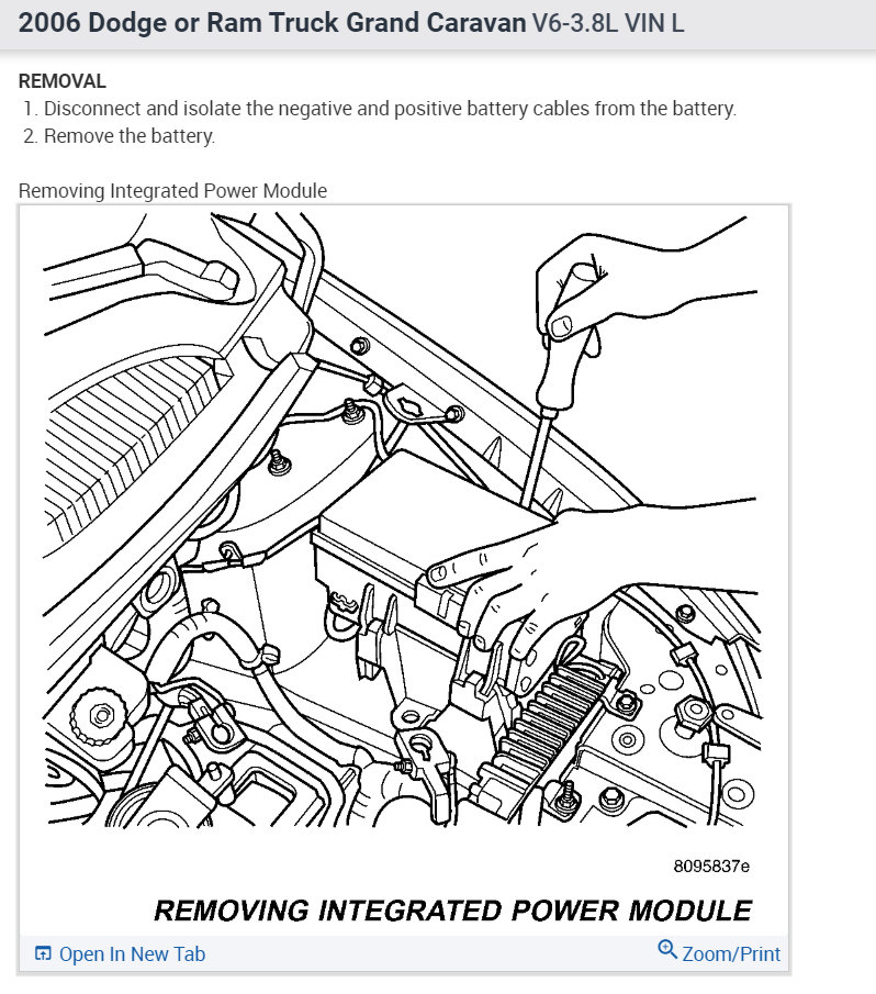

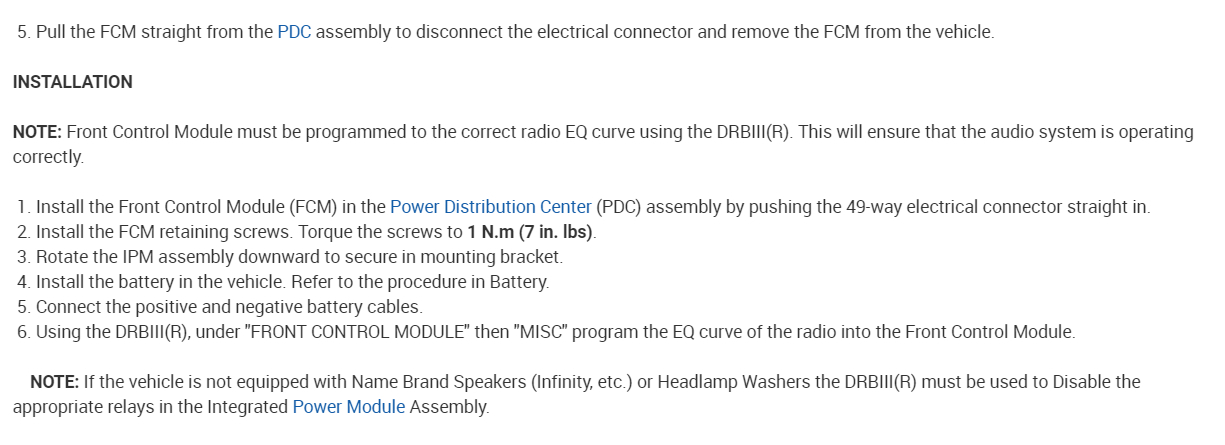

I got codes of p0562,p0700,p0750, p0562,p0700,p0750. Replaced battery and alternator brand new.Van then went into limp home mode. Will go into drive and reverse but will not go into another gear just stays in that gear. Said they were both bad. Didn't fix the problem. so I replaced the transmission shift module, speed sensors, new fluid and filter. Had codes removed after fixing all that and still wont go into another gear. There are no codes whatsoever coming on now and still in limp home mode so is the transmission junk or what?
Dec 11, 2019 at 9:23 AM
  • 55,688 POSTS

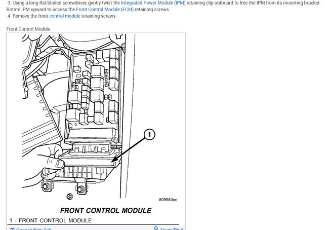

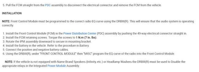

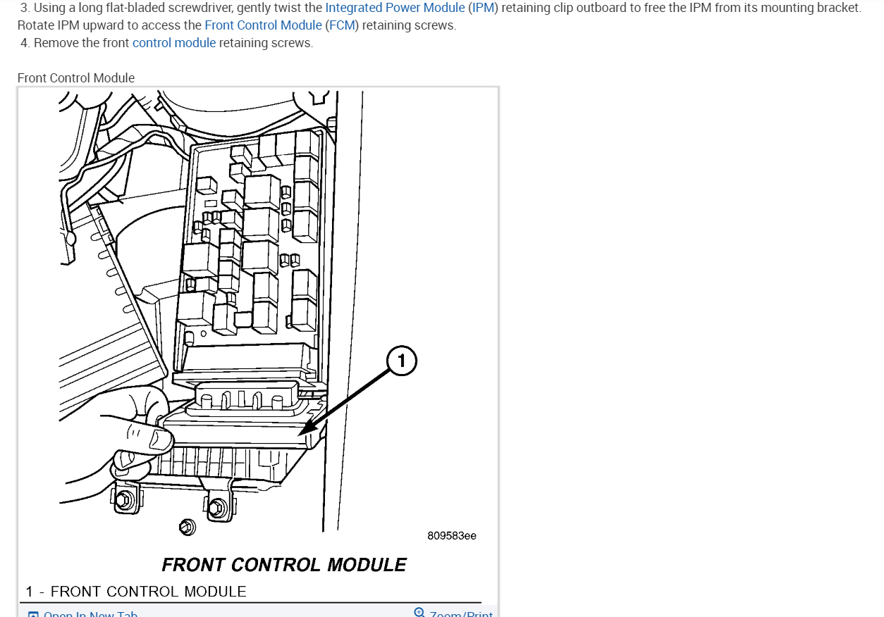

This sounds like a typical IPM module that is out with the p0562 code, but fear not because it is easy to replace because it self initializes. Here are the instructions in the diagrams below. Check out the diagrams (below). Please let us know what happens.

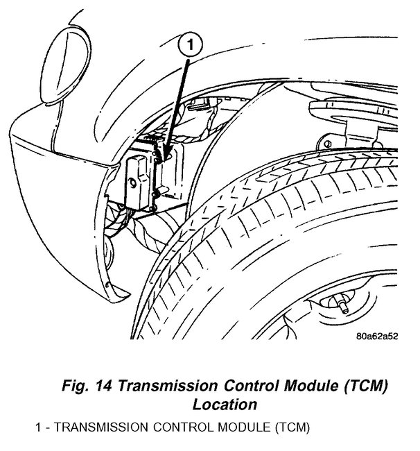

There is a separate control module for the transmission. I believe that is what he is referring to. We need to know if that was changed. Also, if you have a scanner that can read transmission diagnostic trouble codes, are there any stored? When you shift the gears, does the transmission gear indicator show you changed to a gear or not? Diagnostic trouble codes are important with this to determine if there is a wiring issue or if the TCM is bad.
Are the components you used as replacement of the same year, model, and type as the original parts?

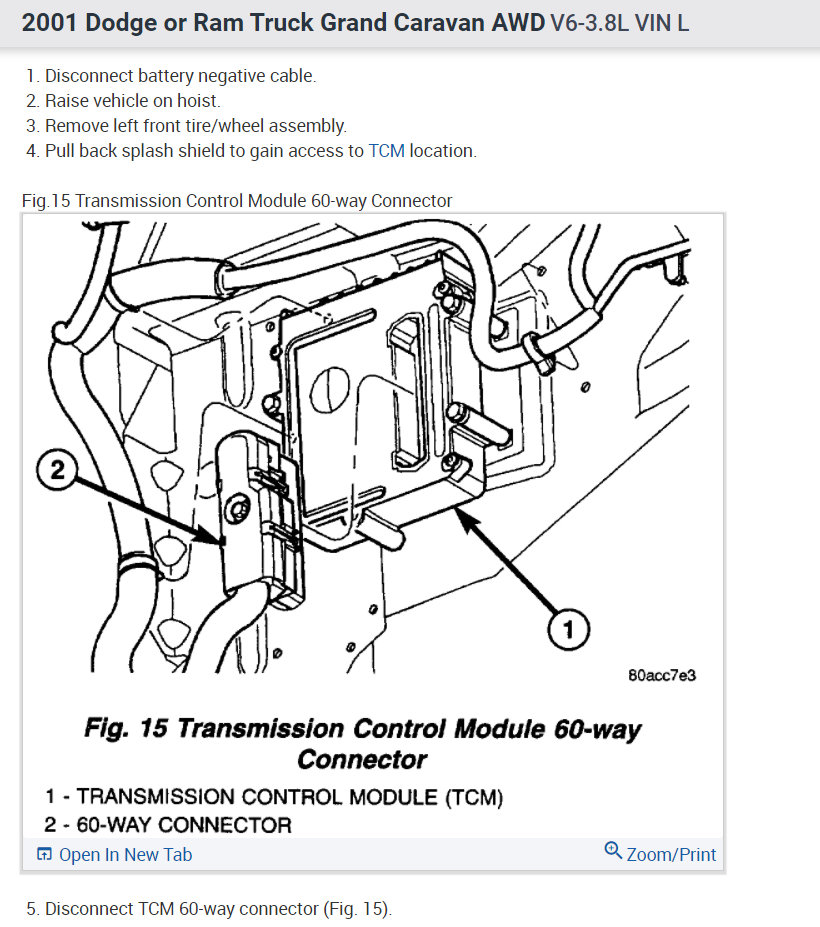

Here is a picture of where the transmission control module is located.
Let us know.

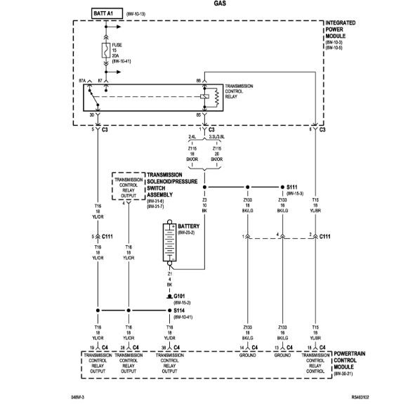

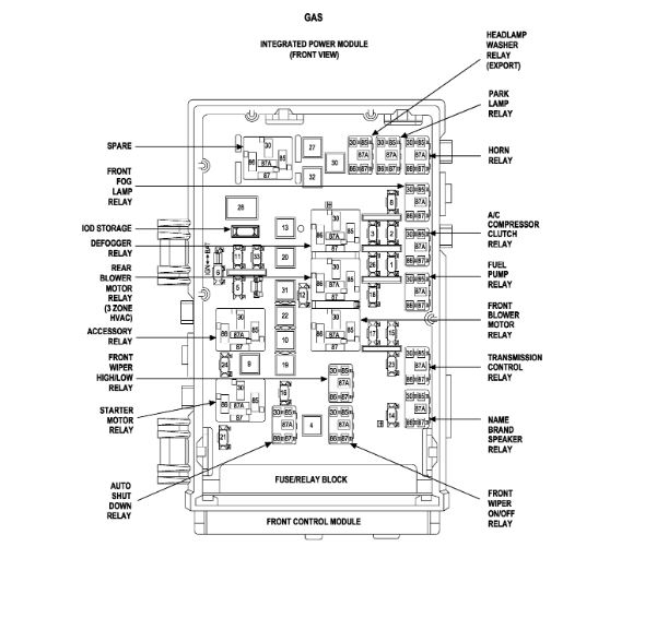

Does the van SE model listed above have a transmission relay switch? I am getting code p0700 and p0888 saying transmission relay sense circuit and I think the PCM, ECU, ECM and TCM are one unit. I am not sure but that is what it looks like and I am trying to make sure before I replace the computer.
May 21, 2021 at 7:54 AM (Merged)
Good afternoon.
I attached a diagram for you and the location of the transmission relay.
In most cases, this is not the relay but a harness issue for the relay. Make sure you check all the possibilities to determine the failure. Verify powers to the relay using a test light.

I am getting P0700 code and I cannot clear it. I dont know what to do. I understand this is a code for the TCM. I cannot locate the TCM on this engine. I have found several diagrams of the engine, but still cannot find where the TCM is located.Any suggestions would be appreciated.
May 21, 2021 at 7:55 AM (Merged)

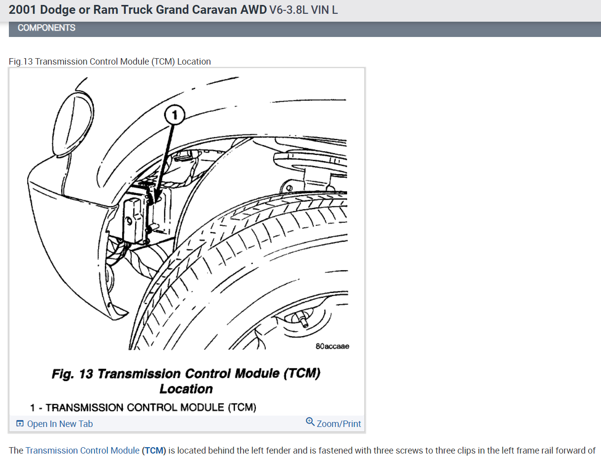

STEVE W.
  • 15,403 POSTS

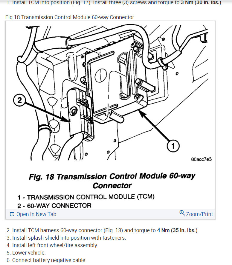

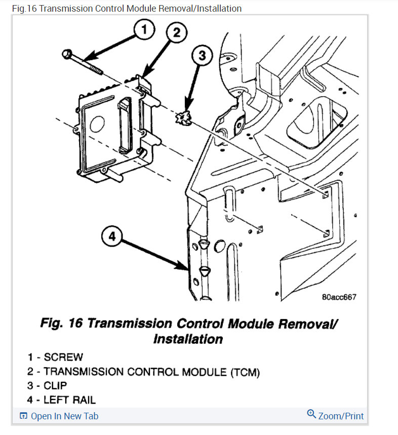

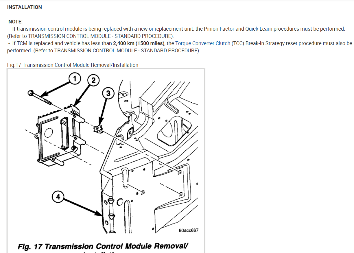

It is behind the splash shield in the left wheel well, mounted to a bracket.
But a P0700 can be a bear to erase. Normally I will clear the codes, then disconnect the battery cables, touch them together for thirty seconds, Re-connect them after about twenty minutes, and clear the codes again. Now if you do not see the P0700 code, turn the key on engine off and slowly shift through the gears. When you get back to park, scan again. If you now have a P0700, swap the TCM. You will need to do a pinion factor reset and quick learn to get the new TCM working. Check out the diagrams (Below). Please let us know what happens.

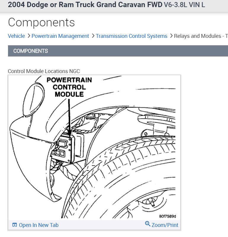

HUGHBORGDRONE
Where do I find the trans control module on a 2001 Dodge grand caravan sport 3.3l. Mine is going bad and I need to replace it.
MERLIN2021
  • 17,250 POSTS
On the left side of the tranny. Here is the location and how to replace it. Check out the diagrams (Below). Please let us know if you need anything else to get the problem fixed.

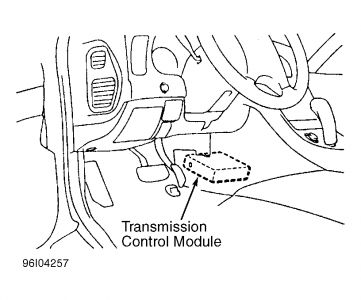

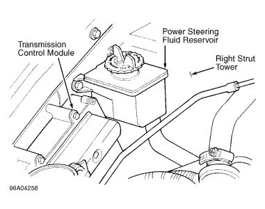

OBXAUTOMEDIC
  • 3,711 POSTS
The Code P0700 is Transmission Control System Malfunction or the Transmission Computer. The only thing so far I have been able to find on Code P1789 is OD/2-4 HYDRAULIC PRESSURE SWITCH CIRCUIT. Which could be just the Selenoid Pack.Ok, the 45 code info I have says to replace the TCM (Tansmission Control Module) Here are the 2 locations... Depending on Body Style... FJ22 Body
https://images.2carpros.com/forum/automotive_pictures/188069_97caravanTCMfj22body_1.jpg
NS Body
https://images.2carpros.com/forum/automotive_pictures/188069_97caravanTCMnsBody_1.jpg

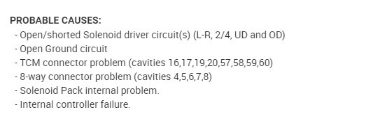

A604
  • 38 POSTS
I have a a604 with an eatx2 TCM. I have intermittent at start up limp mode problem, I have one code (43) od solenoid circuit failure. I checked resistance of the solenoid it was 1.8 ohms, then I unplugged TCM 60 pin and Solenoid pack 8 pin to check wire it too was good, Does that mean my TCM IS bad?
I attached the possible causes but you are on the right path. If the solenoid is new and the tests ok, and the wiring is ok, the only other possible causes are the actual terminal ends or the TCM.
Just do a drag test on the terminals to make sure they have good tension and then you should be good with a TCM.
Let me know what you find and we can go from there. Thanks
