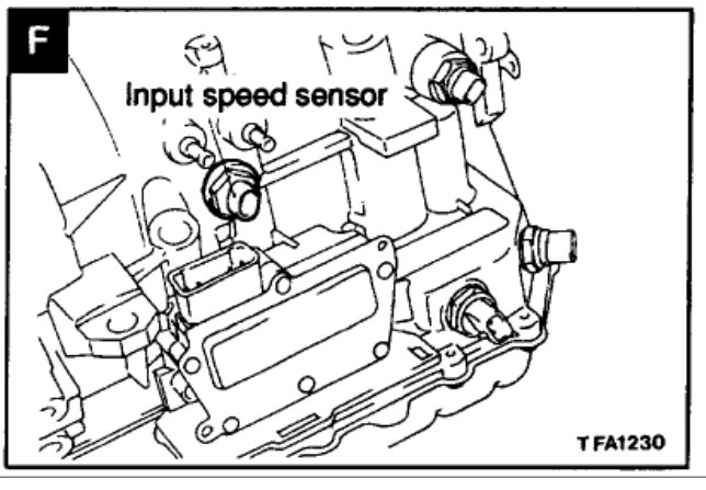

My car is stuck in second gear. Reduced power codes It is throwing is incorrect gear ratio in first and reverse. Just changed the filter and fluid in it yesterday.

Hi TUNERLOVER98,
Was the problem there before the fluid and filter replacement or did it only occur after?
What codes are present? Check the wire harness around the transmission and its sensors for proper connections.
Start with this.

It was there before codes that are showing are p0731 incorrect first gear ratio and p0730 incorrect reverse ratio. I am thinking it is the speed sensors or the solenoid pack.

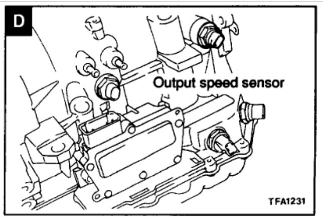

Yes, you would be right the turbine speed sensor is where I would start. Here is its location.
Here is a video of one getting installed and the location for your car below:
https://youtu.be/f3bETtCIdxM
I gave you both sensor location so you do not get them mixed up.

Thank Ken, :) I already have the speed sensors and solenoid pack ordered and delivered. :) I really hope it is what is causing the codes. From what I have watched they usually cause the problem with the 41te transmission. Cheers
