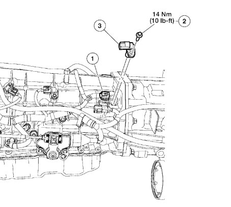

I would start by checking the transmission fluid level ad condition, see if the fluid is burnt which means the transmission is bad and needs to be rebuilt, but we should replace the OSS as well and then clear the codes if the fluid is okay.
P0720 - the PCM is unhappy with the output shaft speed (OSS) sensor circuit/signal
P2106 - is usually a secondary “failsafe / forced limited power” code
P1700 - points to a transmission fault request to the PCM.
Here is the location of the output speed sensor so you can swap it out. Check out the images (below). Let us know how it goes

Thanks, I checked and replaced the fluid and those were the codes after. My next step was to replace the OSS, however the scan tool I used to check during operation showed all the sensor were sending back the correct numbers. In the case that the TCM is the problem, I was wondering how to replace it if the reset methods don't work.

So there is no TCM, the transmission is controlled through the engine PCM.
