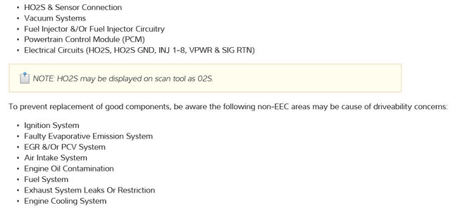

I was pulling out of store like normal and kinda jamming on it then it through two codes and is like its in limp mode. I only get like half throttle response. seems to run fine at low rpms. I reset them but, they were p0500 and p1131. It's still running the same but, I haven't driven it enough for the codes to come back. I recently changed the fuel pump and speed sensor. The used motor was just put in when I bought it.

0500 is speed sensor in trans which could be bad or it's a wiring issue/pcm problem. for 1131 see pic for problems associated with it also check fuel pressure with a gauge auto parts rent it.

the speedo not working may be a bad dash causing that . check the items that are in pic like partially clogged egr system etc. or vacuum leak. also the people that changed the motor may have done just that and not changed oil etc.
