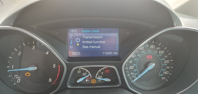

Hi there, I have the vehicle listed above Titanium X with a powershift gearbox 117002 miles. It had limited transmission function show up 4 months back so sent it to garage and had to recondition the gearbox. Now I've had it back 2 months and now it is showing the same message. Thanks.

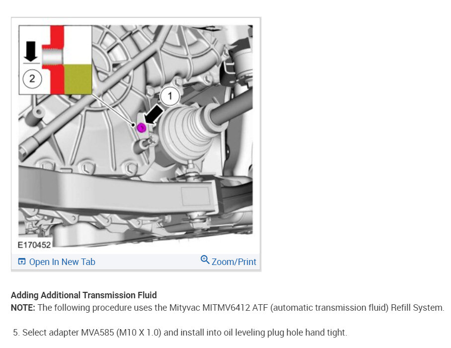

The first this we need to do is scan for codes, this guide will help:

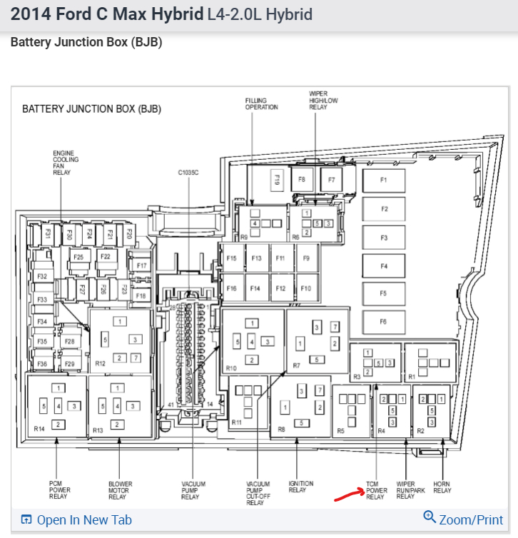

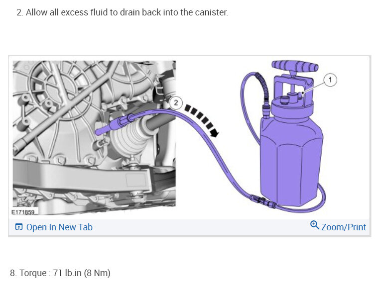

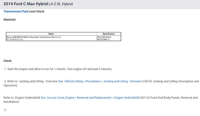

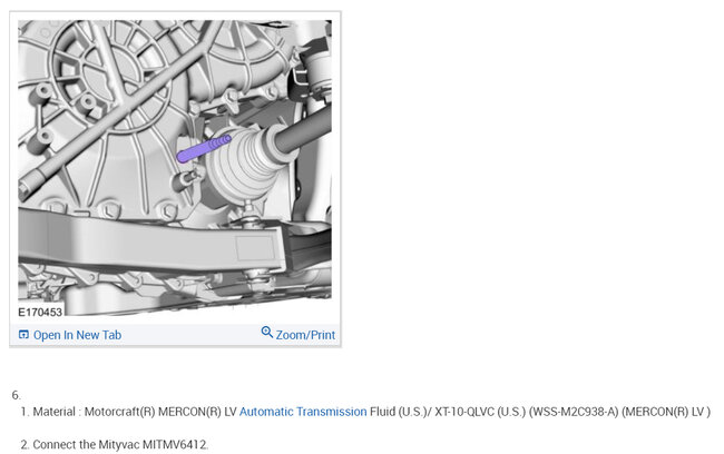

I have seen one of the electric hybrid motors go out, also I would swap out the TCM power relay, when they start to go out it can cause this light to come on, here is the location so you can check it out. Let's check the transmission fluid level as well. Check out the images (below). Please let us know what happens.

Its not a 2014 hybrid mate. Just 2013 Diesel

Okay, we still need to run the codes and check the transmission fluid. Can you please do that to see what you find?
