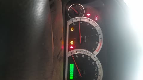

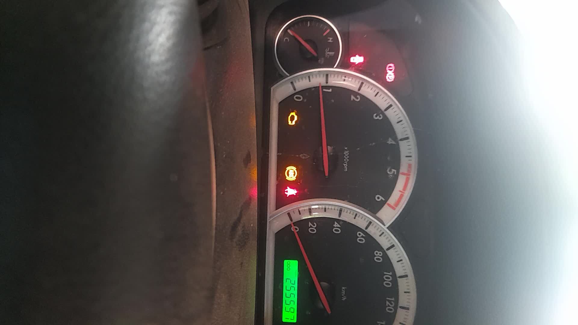

After engine renewal it won't accelerate to upper 1,200 RPMs, at this point begins vibration and noise. The mil is on but there's no dtc. Please help.

Hi Mr. Ken.
The turbo is working, it gives pressured air in the outlet.
There is a video for the dashboard and for the shaking engine with knocking.

The turbo is working, it gives pressurized air at the outlet. Please find here a video showing the dashboard and the shaking engine where you can hear the knocking.
Maybe there is an injector which does not receive orders from the PCM. In this case, please tell me how to repair it.
Thank you very much.

Thanks for the video. The engine seems to have an internal problem, or it was weak fuel pressure, can you give me more history on this car? Is the engine rebuilt or used? Also, is the flywheel tight?
