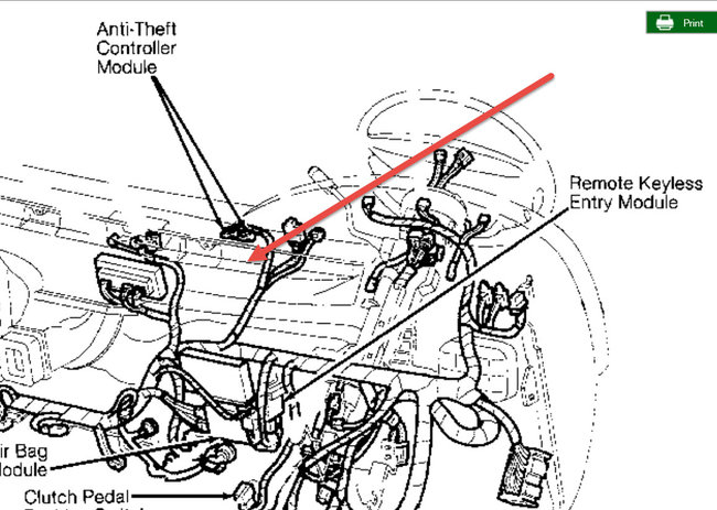

Changed switch and plug going into switch, still same problem. Not sure where warning module is located.

try disconnecting anti theft module if lights go out the module is bad however your truck won't start

There's a white plug and a black plug. Unplug the white plug and the dinner went off and the lights went off.
Mar 13, 2016 at 2:06 PM
JCLUCKIE
  • 7 POSTS
Okay I'm hooked the white plug lights went out did start though. Do you think that the module is bad? Can I run it with a just unplug? Or do you recommend changing it?
Mar 13, 2016 at 2:23 PM
JCLUCKIE
  • 7 POSTS
Un hooked white plug
HMAC300
  • 48,601 POSTS
try running it like that and if it gets to where it won't start try hooking the plug back up if it starts you are golden
