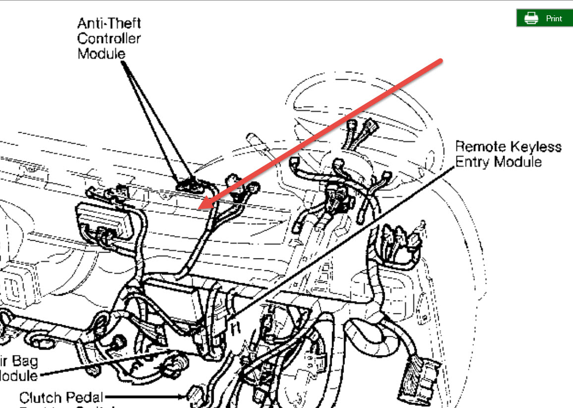

All the external lights stay on when you turn off key. The dinger still dings with out the key in ignition and the headlights and running lights stay on. Help please

Changed switch and plug going into switch, still same problem. Not sure where warning module is located.

try disconnecting anti theft module if lights go out the module is bad however your truck won't start

There's a white plug and a black plug. Unplug the white plug and the dinner went off and the lights went off.

Okay I'm hooked the white plug lights went out did start though. Do you think that the module is bad? Can I run it with a just unplug? Or do you recommend changing it?

Un hooked white plug

try running it like that and if it gets to where it won't start try hooking the plug back up if it starts you are golden
